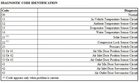

This does not seem to be any simple malfunction. See if you can retrieve any trouble codes. RETRIEVING CODES Indicator Check 1. Press and hold AUTO and recirculated air switches. See Fig. 2 . Turn ignition on. All indicators will flash 4 times at one-second intervals. Tone will sound when indicators flash. 2. A/C system will automatically enter diagnostic code check mode. To end indicator check, press and release OFF switch. Read codes at temperature display. See Fig. 2 . If a normal code (Code 00) is displayed but problem persists, go to symptom chart. Trouble shoot symptoms in numeric order from lowest to highest. 3. If trouble code is displayed, proceed to appropriate trouble shooting procedure. See DIAGNOSTIC CODE IDENTIFICATION table. Codes are displayed in ascending order. To slow rate at which codes are displayed, press fresh air button to change display to step operation. Each time fresh air button is pressed, display changes by one step. 4. If tone sounds as code is displayed, problem currently exists. If tone does not sound as code is displayed, problem occurred in past and does not presently exist. If ambient temperature is -4 °F (-20 °C) or less, code may be displayed even if system is functioning normally.

Based on your testing guide, two codes came up. They are: 42 and 21. Only 21 beeps and therefore it this is what is causing the problem. Where will I find the Solar Sensor Circuit to replace it?

The solar sensor is a dealer part and can only be purchased from them. Alternatively you can try the junkyard to see if they have it. Before replacement of the sensor, testing should be carried out to determine if it is the sensor or other faults.
A control panel fault can also cause the code to be stored.
Do you have a DVOM and can you perform resistance tests?

Hopefully you didn't shell anythjing out for the solar sensor before being made aware of the FM note stating that the solar sensor may throw a code if the test is done in a dark area. You can simply shine a light on it to eliminate it as a candidate (no code if normal). I'm wondering if the Online Mitchel manuals contain these important notes?
