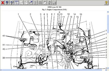

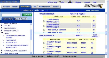

A friend of mine has a '98 lexus sc 300 with a 3.0 liter v6. she recently started getting horrible fuel mileage and experienced a substantial loss of power. she brought it to a master mechanic and after scanning the car he stated that bank 1 sensor 1 was bad. is this the sensor i can see inserted into the side of the exhaust manifold? he also quoted her a 600 dollar parts and labor charge. so at about 10 hours lf labor, or so he says, i am wondering if he is overcharging her and if i am looking at the correct part. thanks for your help
Aug 20, 2008 at 7:17 AM
  • 75,992 POSTS
B1S1 is located at item no.3 see below
https://images.2carpros.com/forum/automotive_pictures/12900_b1s1_2.jpg

https://images.2carpros.com/forum/automotive_pictures/12900_labor_and_part_1.jpg
I don't see 10hrs of labor on it-He's definitely overcharging-for $600.00
