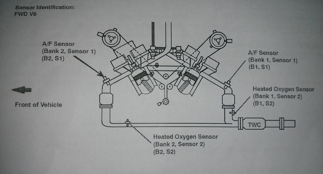

There is Check Engine and VSC light. I did check with OBD scanner. There are Error code P2238 and P2241
When I check with Mechanic, he told me to change O2 sensor.
I am just checking in internet, there are lots of conflicts. Some one say O2 sensor some one say A/F sensor.
Can you please let me know which sensor to change and any universal sensors works in this case ?

that is an A/F sensor shorted out or problem in that area

Thanks for your reply. There is confusion due to OBD database. It says all are O2 sensors But we need to differentiate based location data like bank1 sensor 1 and bank2 sensor 1.

an O2 sensor is not going to fix this . this is caused by the a/f sensor shorted out or having problems in wiring to a/f sensor. but if you really must know, bank 1 is where #1 is and #1 sensor is before converter.#2 sensor after converter.
Feb 26, 2014 at 10:02 AM
SRINI123
  • 7 POSTS
I got this image from other thread. It says AF sensors are top of the engine and O2 sensors are bottom of engine.

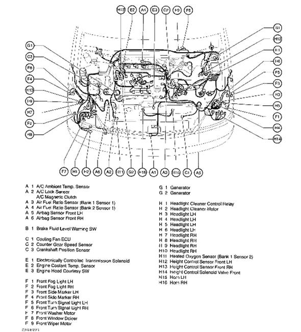

an a/f sensor is what an O2 sensor isrock auto has them form $80-120 and denso is the supplier of oem parts.

heres a pic item A3 and A4 but I think it's beyond your capabilities.
Feb 26, 2014 at 12:05 PM
HMAC300
  • 48,601 POSTS
forgot pic
