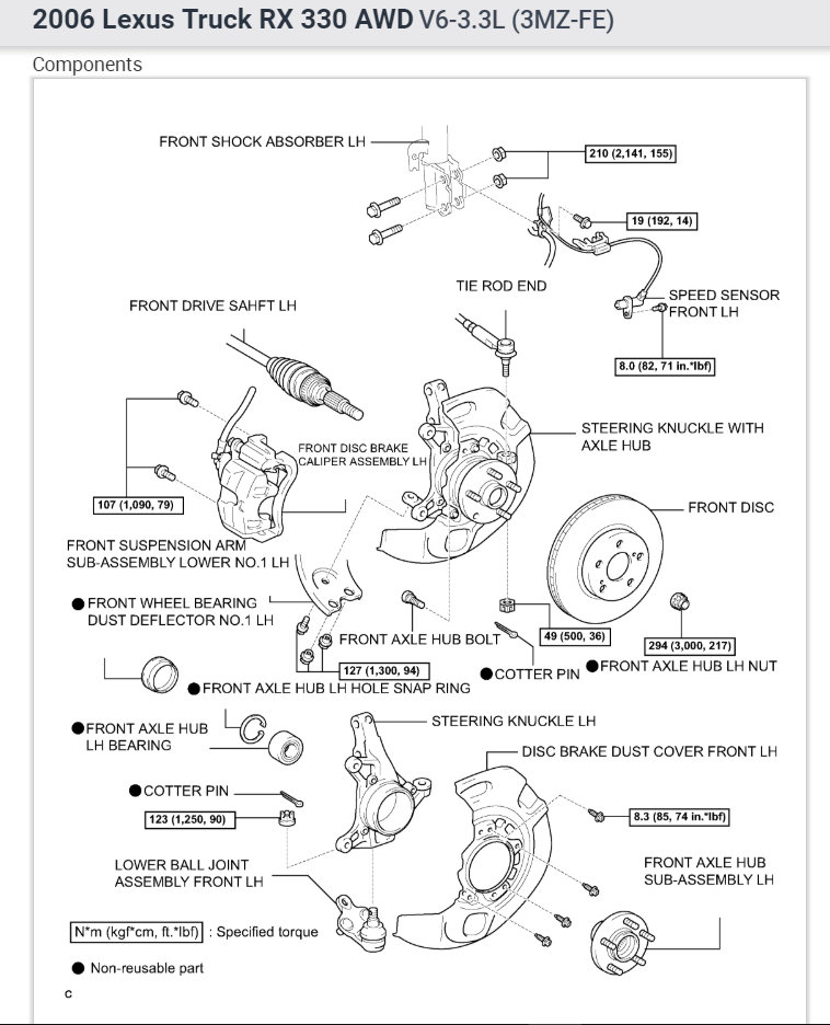

Hi. Occasionally, the "brake", "VCS", "ABS", "Trac off", and flashing "tire pressure" warning lights all go on at once. They then stay on until the vehicle is turned off. I maintain the car well with a Lexus repair tech. He says everything is in good shape, and doesn't know why this is happening. The dealership didn't have any idea either.

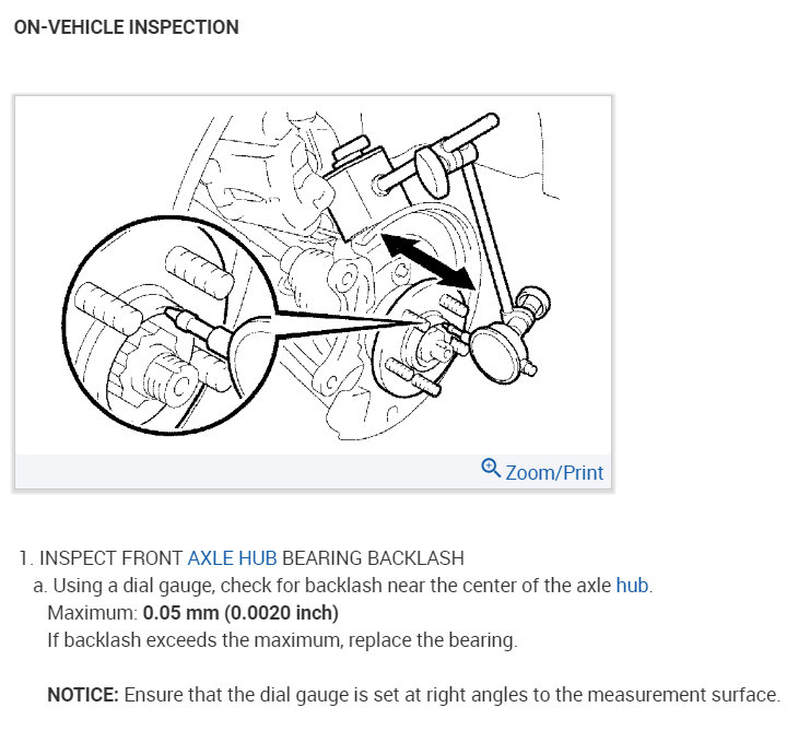

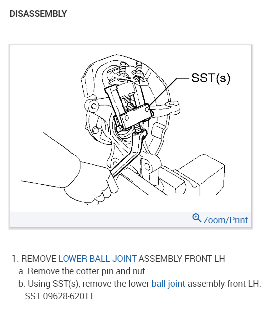

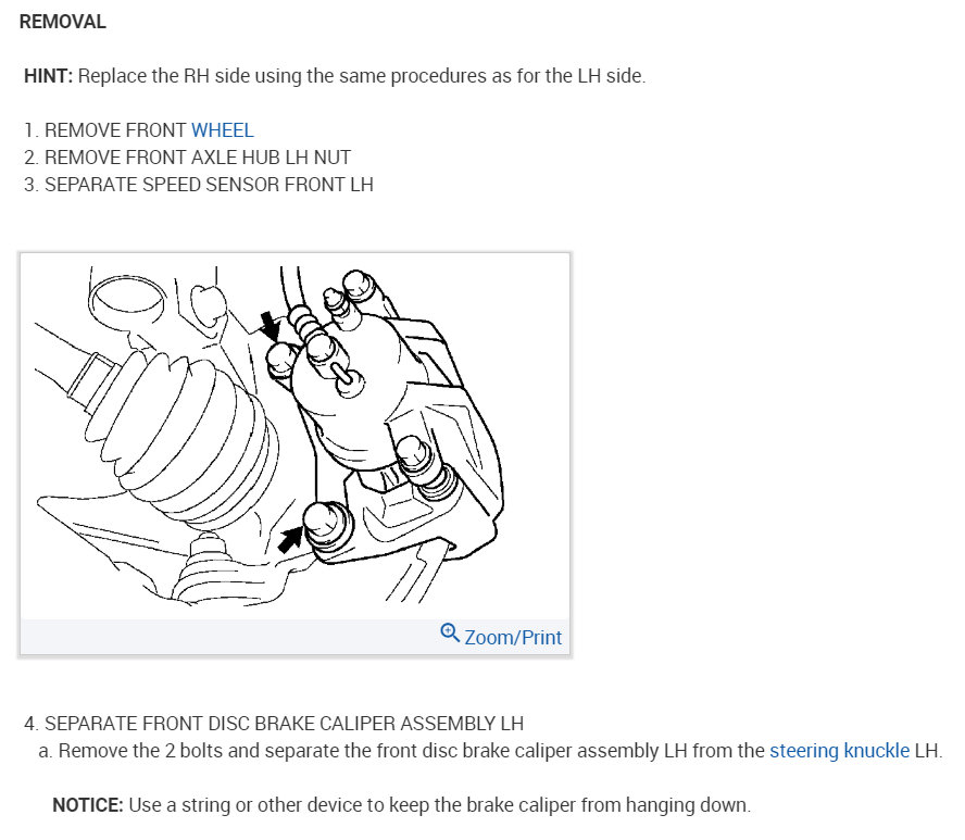

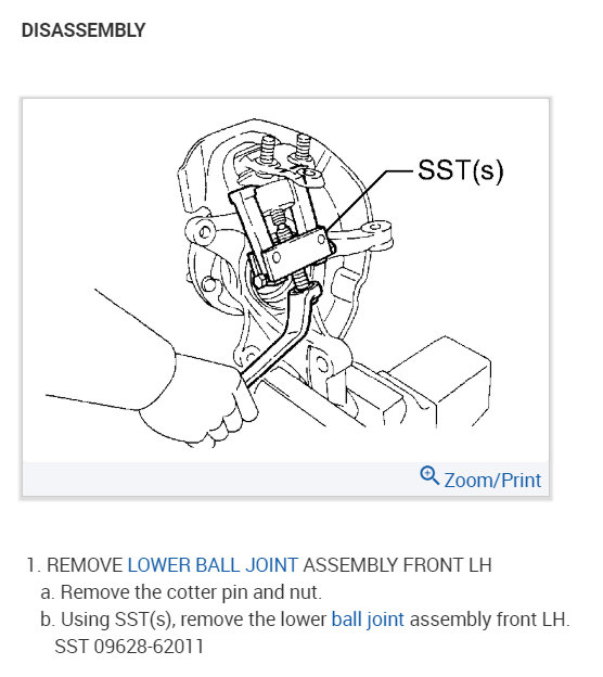

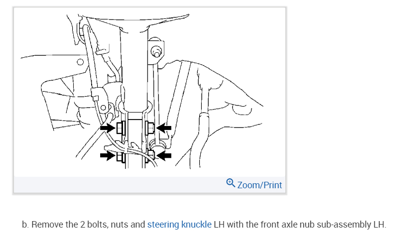

This happens when the front wheel hub on either the right or left goes out making the wheel speed sensor not work right. But to be sure lets run the codes to see what comes up here is a video to show you how.
https://youtu.be/rTtAnsOlZU4

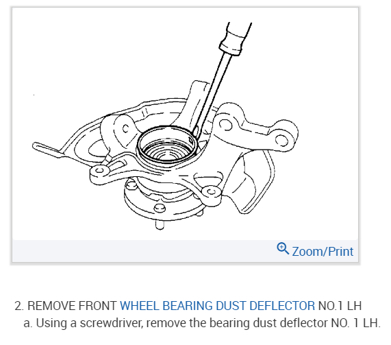

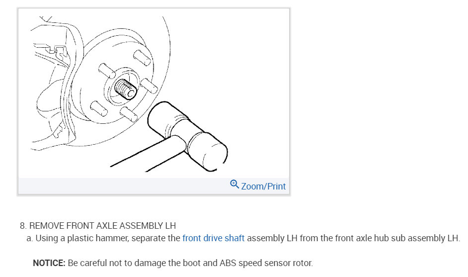

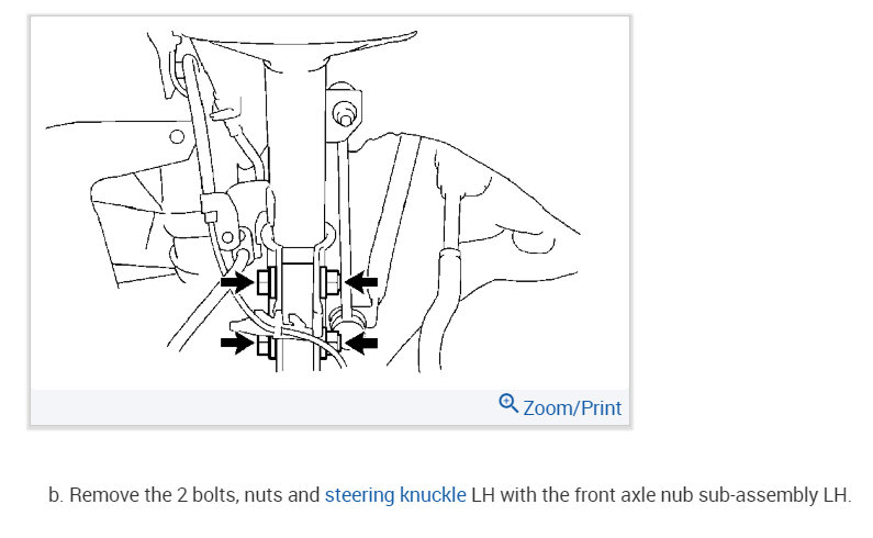

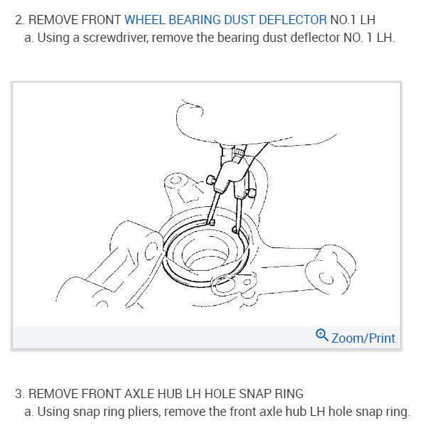

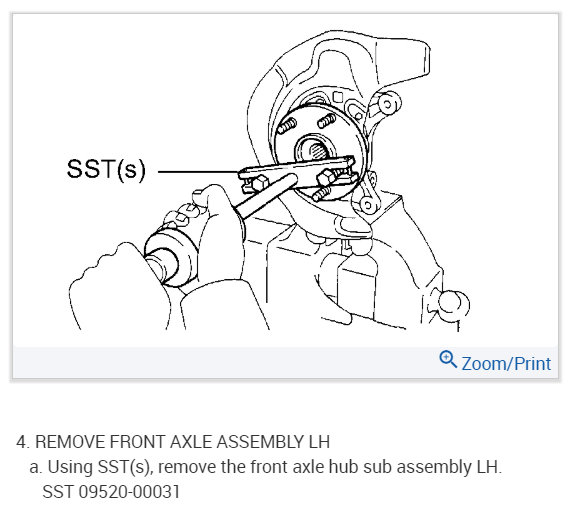

If it gives you a wheel sensor code here is a guide to help you change the axle bearing out. I would do both sides with diagrams below to show you on your car
https://www.2carpros.com/articles/how-to-replace-a-cv-axle-bearing
and
https://www.2carpros.com/articles/how-to-replace-an-abs-wheel-speed-sensor
Cheers
