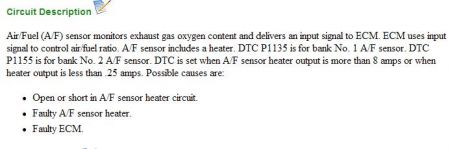

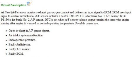

CHECK ENGINE CAME ON ABOUT 45MILES AFTER I HAD PUT NEW BATTERY IN . I ALSO PUT FUEL CLEANER IN THE CAR. THE CODES ARE P1130 and p1135

Sounds like your vehicle did not like the fuel cleaner you used. CODE P1130

CODE P1135
https://images.2carpros.com/forum/automotive_pictures/261618_Noname_127.jpg
I suggest driving the vehicle through another fuel cycle with the recommended octane level. Then reset the engine code and see if it comes back. I believe the fuel cleaner just messed with some of the sensors and the computer is giving off a "false alarm". Hope this helps.. Thanks for using 2carpros.com!
