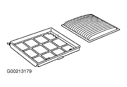

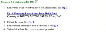

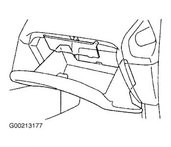

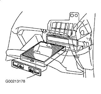

How do I change the cabin air filter ? I know access is through the glove box but I don't see where to access it.
Jun 16, 2009 at 11:17 PM
MHPAUTOS
  • 31,937 POSTS
Hi there, See text & pics for this procedure. Mark (mhpautos)
