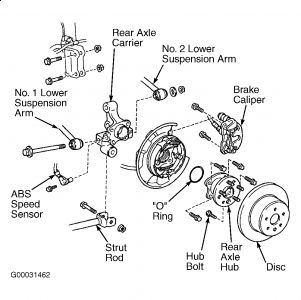

I just replaced the Left rear wheel bearing, now the anti skid light comes on and the car boog down then goes . once it goes it's fine till you stop or turn, then it boogs and chatters.

https://images.2carpros.com/forum/automotive_pictures/99387_Graphic1_438.jpg
Check for damaged ABS speed sensor pull codes good luck

tried that , OK

that was the first thing I checked , there was no damage to it.

Use an ohm meter and check it
disconnect it and ohm check for continuity
and need to have the ABS system check for codes
