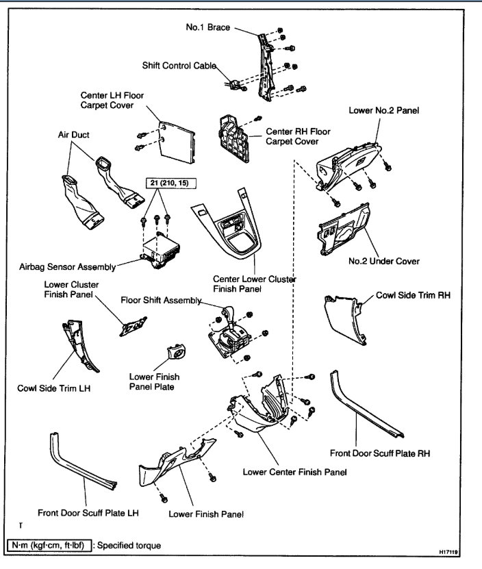

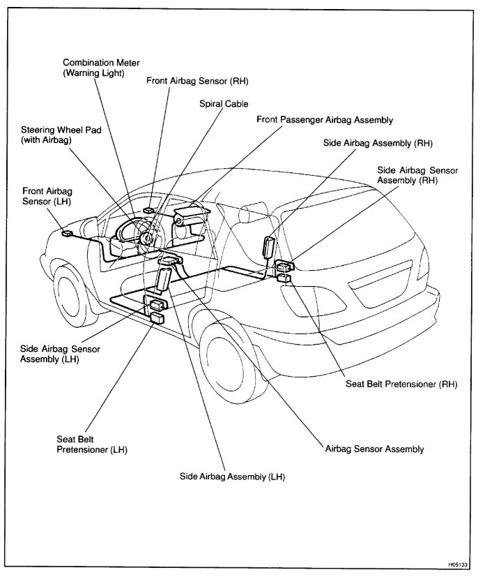

Where is airbag module location?
Oct 12, 2009 at 1:49 PM
BMRFIXIT
Experienced Mechanic
19,053 POSTS
The air bag module or air bag sensor controller is in the middle of the center console toward the front. Check out the diagrams (Below). Please let us know if you need anything else to get the problem fixed.
