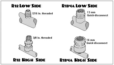

What type of Freon to charge A/C?
How to do it?

It takes the R134a, You hook it up on the low pressure side. Don't know where the fittings within the AC piping use below for reference to ID the ports
