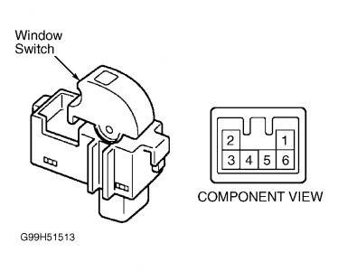

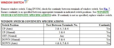

Recently, my drivers window stopped working intermittantly. Now, the other 3 windows do not work at all, and the drivers window is the only one working, on and off.
Aug 25, 2009 at 7:54 PM
BLUELIGHTNIN6
  • 16,542 POSTS
do the other windows work from their individual switches?
Aug 25, 2009 at 10:21 PM
WRENNR
windows do not work by their individual control
Aug 25, 2009 at 11:56 PM
BLUELIGHTNIN6
  • 16,542 POSTS
ok, you will need to test the master (driver) window switch.
