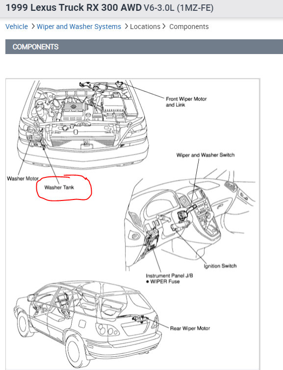

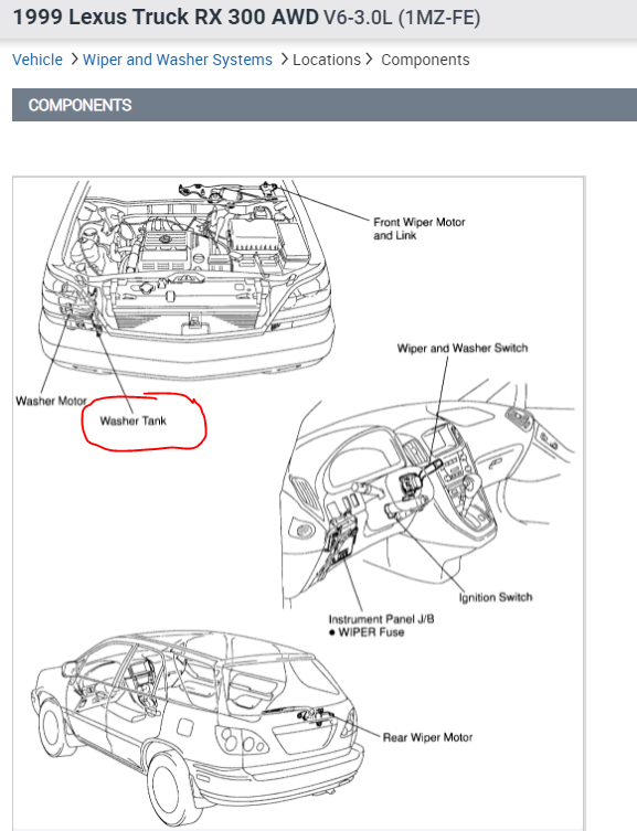

Where is the front windshield washer pump located?
1999 LEXUS RX 300
BCHCREST
Where is the front windshield washer pump located and what needs to be removed to reach it?
May 21, 2010 at 10:45 AM
BLUELIGHTNIN6
  • 16,542 POSTS
washer pump is at bottom of windshield washer reservoir. .
https://images.2carpros.com/forum/automotive_pictures/261618_Noname_2229.jpg
May 21, 2010 at 9:10 PM
SQM
  • 6,383 POSTS
The windshield washer pump is located at the bottom of the washer fluid reservoir.
It can be accessed through the bottom of the vehicle, by removing the splash shield from the passenger side.
https://www.2carpros.com/articles/how-to-replace-a-windshield-washer-pump
I have attached a diagram for your reference.
