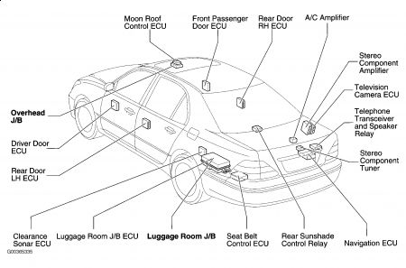

Where is the fuse box located on the 2005 Lexus LS 430? (The parking assist feature stopped working).
Tuesday, March 23rd, 2010 AT 2:32 PM
BLUELIGHTNIN6
  • 16,542 POSTS
Your vehicle has a junction block in the left side of the luggage compartment (trunk) and also an overhead junction block at the front of the roof opening.
