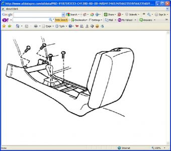

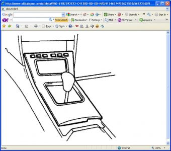

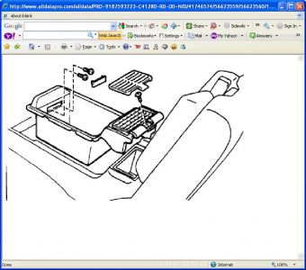

My center leather console is worn out. I bought a used one to replace it. How can I remove the old one. I don't see a way to access the mounting screws.

Service and Repair REMOVE CONSOLE BOX HINT: Tape a screwdriver tip before use. (a) Using the screwdriver, pry out the cluster finish panel, and after disconnecting the connector, remove the Panel. (b) Using the screwdriver, pry out the lower console cover. (c) Using the screwdriver, pry out the cover. (d) Remove the 3 screws and lower console box. (e) Remove the 4 screws and cup holder. (f) Remove the 4 screws and the console box. Installation is in the reverse order of removal. First of all thank you so much for the donation.Here are the instruction's on removing the console.

After this I need to remove the hinged cushion behind the cup holder. It has a leather covered top with air vents and a compartment below. It appears to be held with (4) screws towards the back of the console.
