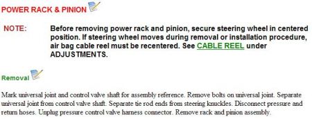

DO YOU HAVE TO REMOVE THE ENGINE TO REPLACE THE STEERING RACK?
Thursday, November 6th, 2008 AT 7:36 PM
MHPAUTOS
MECHANIC
31,937 POSTS
Hi there,
From the Mitchell 1 data base there is no mention of removing the engine, here is what they say, i hope it helps.
mark (mhpautos)
