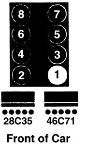

I need a picture to show the firing order for this engine. Would really be grateful for that
Thursday, September 16th, 2010 AT 5:30 PM
3 Replies
MECHANIC
75,992 POSTS
Firing Order: 1 8 4 3 6 5 7 2

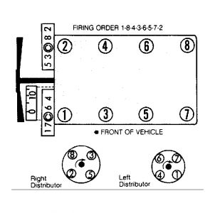

what is the lead configuation and firing order
Monday, December 7th, 2020 AT 8:27 AM (Merged)
MHPAUTOS
MECHANIC
31,937 POSTS
Hi there,
Firing order as per pic.
