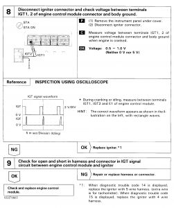

Engine will crank and run for about 1 second then quits.
I pulled OBD code and came up with a "15". The only info I have found on this code is "Ignition Number 2". Does this point to an Ignition control module problem. Thank you for any info.

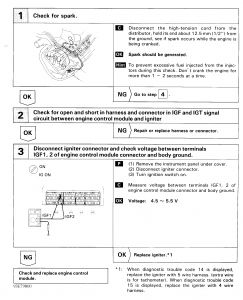

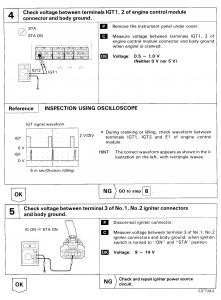

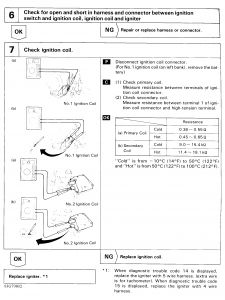

Hope you can read these,they are th eflow chart for code 15 - ignition signal circuit
https://www.2carpros.com/forum/automotive_pictures/1639_1_1.jpg
https://www.2carpros.com/forum/automotive_pictures/1639_2_1.jpg
https://www.2carpros.com/forum/automotive_pictures/1639_3_1.jpg
https://www.2carpros.com/forum/automotive_pictures/1639_4_1.jpg
