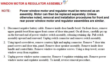

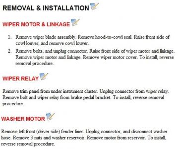

I HAVE A REPLACEMENT MOTOR FOR MY DRIVERS SIDE WINDOW ,HOW CAN I GET THE INSTALLATION INSTRUCTIONS-SAME THING WITH MY WIPER PUMP I HAVE A NEW PUMP BUT CANT FIND OUT WHERE IT GOES. CAN YOU HELP PLEASE

https://images.2carpros.com/forum/automotive_pictures/261618_Noname2_715.jpg
https://images.2carpros.com/forum/automotive_pictures/261618_Noname_2199.jpg
