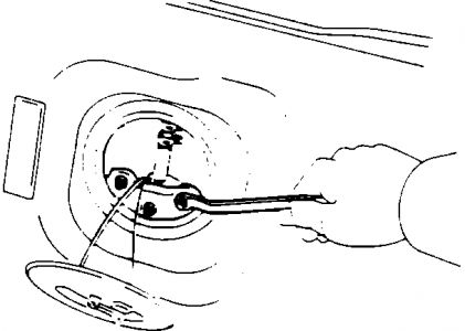

Preparation Disconnect negative battery terminal. Drain fuel into an approved container. Remove front luggage compartment cover. Disconnect fuel pump electrical connector. Remove rear seat back. Remove access hole plug.
https://images.2carpros.com/forum/automotive_pictures/248015_2_29.gif

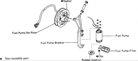

Fuel Pump Removal Remove fuel pump set plate. Pinch hose clamps and slide fuel hose toward pump.
https://images.2carpros.com/forum/automotive_pictures/248015_3_24.jpg
Remove three pump bracket retaining screws. Lift fuel pump from tank.
https://images.2carpros.com/forum/automotive_pictures/248015_4_14.jpg

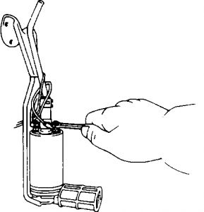

Fuel Pump Disassembly Remove fuel pump wires.

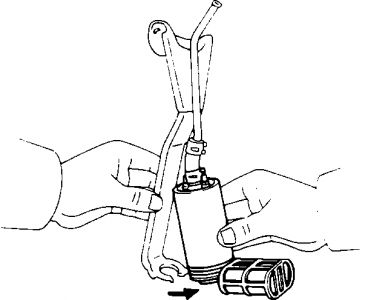

https://images.2carpros.com/forum/automotive_pictures/248015_5_11.jpg
Pull lower end of pump away from pump bracket. Remove rubber cushion.
https://images.2carpros.com/forum/automotive_pictures/248015_6_9.gif
Remove filter retaining clip and filter. Reverse procedure to install. Use a new tank gasket and note the following torque values: Pump bracket - 48 in.lbs (5.4 Nm) Pump set plate - 26 in.lbs (2.9 Nm)
