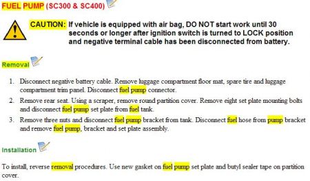

Where is the fuel pump located and how do I remove and replace it?

Hi there, The pump is internal in the tank see text for details. mark (mhpautos)
https://images.2carpros.com/forum/automotive_pictures/61395_fuel_1.jpg
