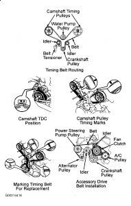

Timing marks
Jan 27, 2010 at 10:57 AM
MHPAUTOS
  • 31,937 POSTS
Hi there. Timing marks as per pic. mark (mhpautos)
