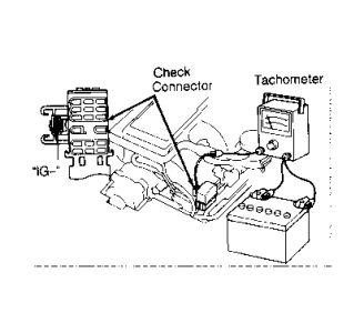

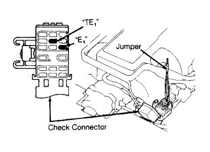

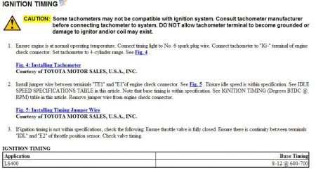

WHAT ARE THE SPECIFICATION FOR SETTING THE TIMING ON THIS CAR
Aug 28, 2008 at 10:00 AM
MHPAUTOS
  • 31,937 POSTS
Hi there, Checking ignition timing as per instructions in pics. Mark (mhpautos)
