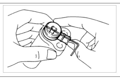

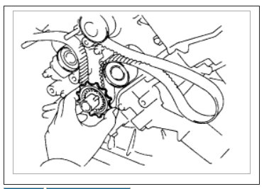

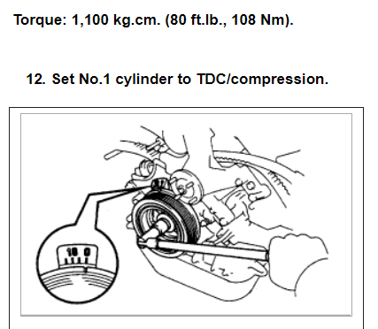

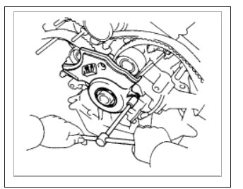

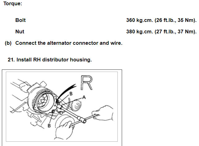

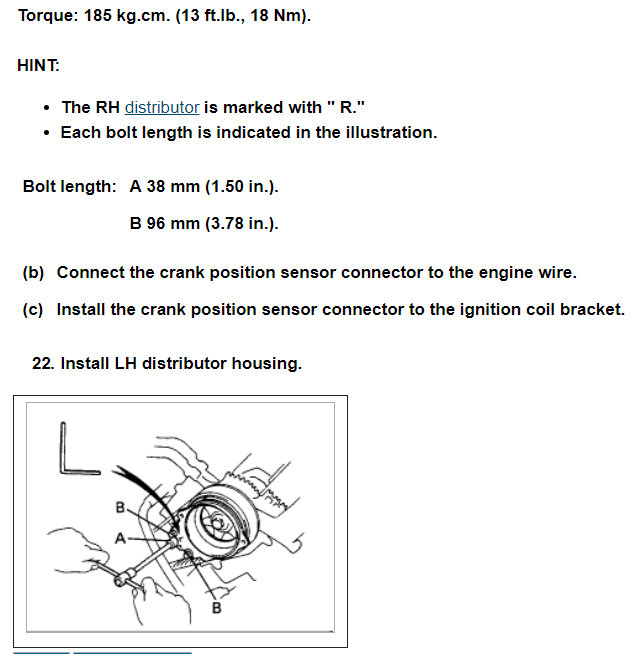

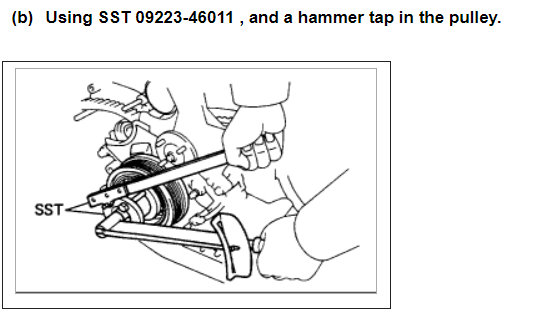

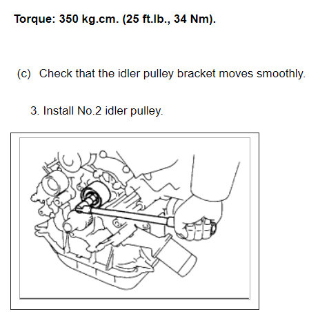

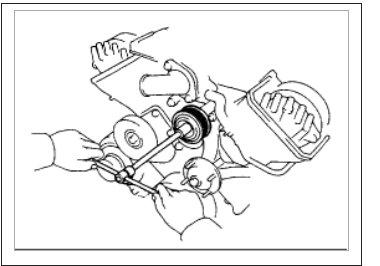

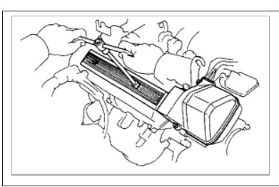

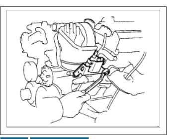

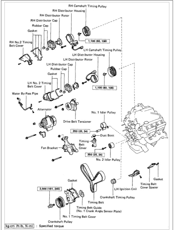

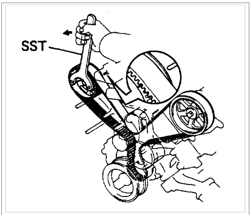

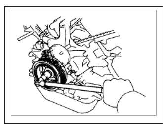

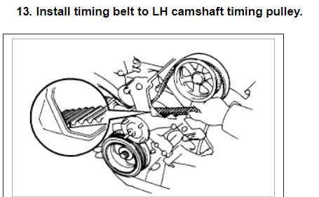

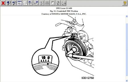

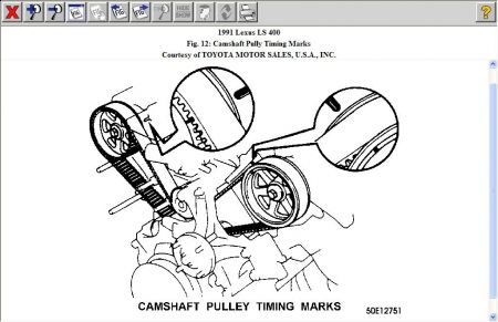

How do you line the cams and crank up i put a new water pump the car miss a little?

how do i set the cams to the compression side.

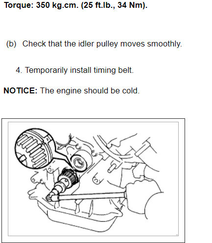

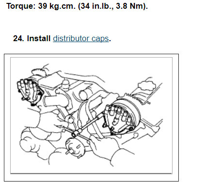

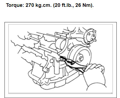

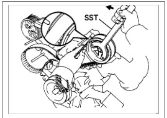

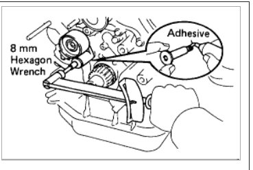

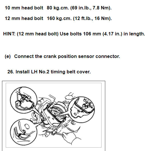

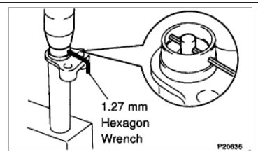

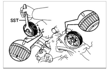

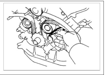

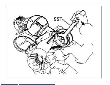

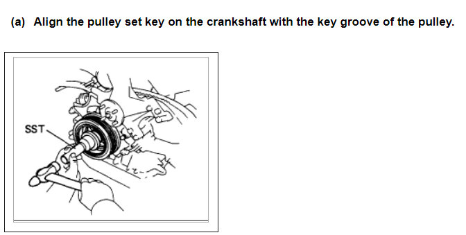

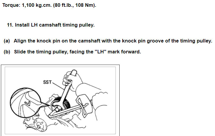

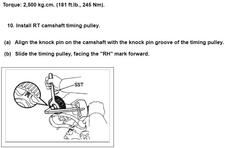

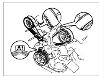

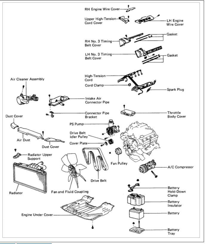

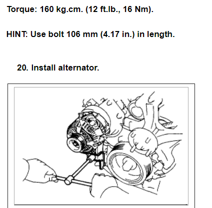

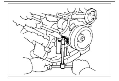

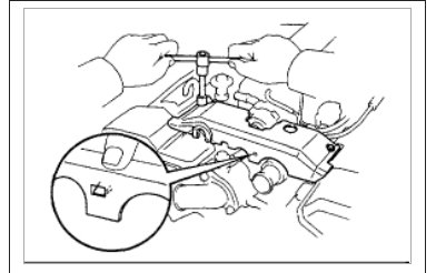

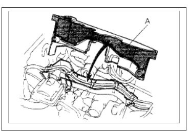

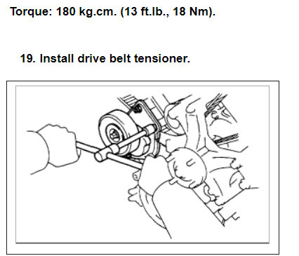

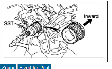

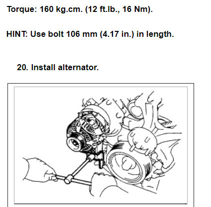

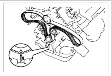

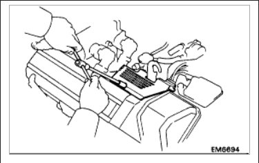

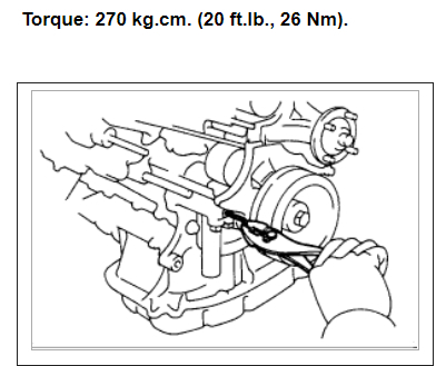

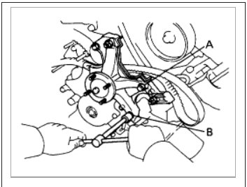

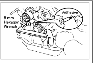

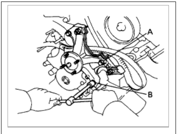

Hello, It is involved a little it but I have all of the diagrams you need to get the job done. (below)
Please let me know if you have any questions
Here is a guide to remove the harmonic balancer
https://www.2carpros.com/articles/how-a-harmonic-balancer-works
and
https://www.2carpros.com/diagrams/lexus/ls-400/1991
