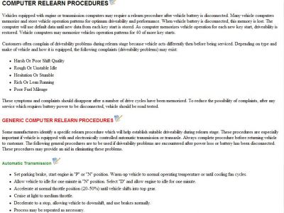

Does anyone know how to reset the ECM on a 91 lexus?

Hi there, Re set procedure as per text. Mark (mhpautos)
https://images.2carpros.com/forum/automotive_pictures/61395_snap_1_30.jpg
