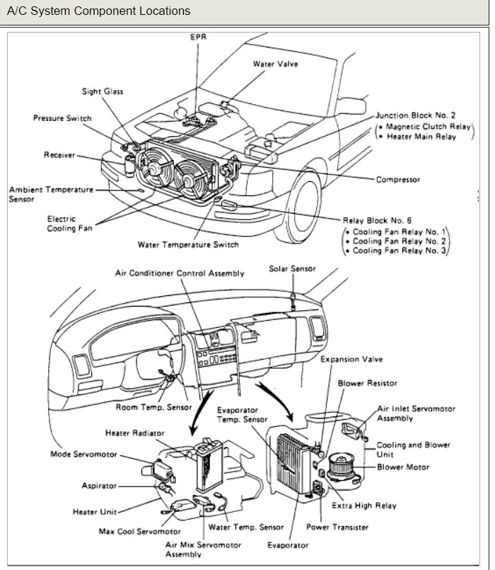

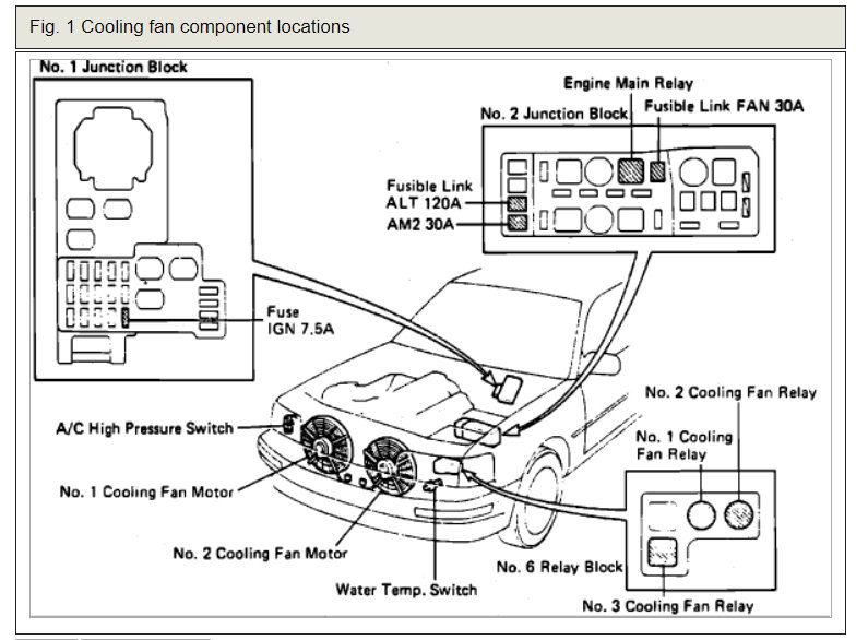

I have found the locations for you and a test guide so you can confirm the failure.
https://www.2carpros.com/articles/how-to-check-an-electrical-relay-and-wiring-control-circuit.
If the cooling fan is bad this guide will give you an idea of what you are in for when doing the job.
https://www.2carpros.com/articles/replace-electric-fan-motor
I have also found these diagrams to help you see what you will be fixing.
Cheers

I uploaded a picture of the compartment I think you are referring to with the top diagram showing. Can you tell me which relay it is? No water in the cooling system? Is that the radiator overflow?
https://images.2carpros.com/forum/automotive_pictures/154609_lexus_engine_2.jpg
P.S. I wired the fans directly to the battery and they worked fine so the motors are good Thanks
Feb 7, 2008 at 9:16 AM
2CARPRO JACK
  • 11,533 POSTS
The legend on the post above shows which relays are which. Check it out :)

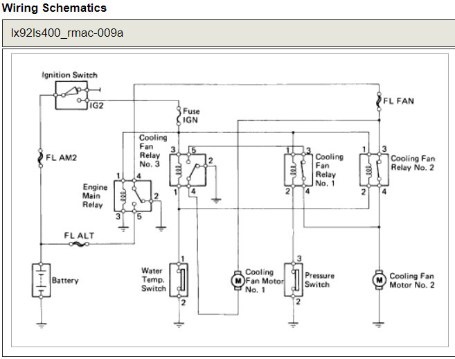

Check for power on the Yellow/Blue wire at the Water Temperature Switch (located on the left front of engine compartment - on the radiator).
Next make sure that the White/Black wire on the Water Temperature Switch makes a good ground. (Use an ohmmeter. With the Water temperature switch disconnected, connect one ohmmeter lead to the wht/blk wire on the Water Temperature Switch connector and the black ohmmeter lead to the negative battery terminal. The ohmmeter should read "0". If not. Clear the area where the Water temperature switch grounds on the right front fender.)

Check COOLING FAN RELAY 2 to see if it has power on terminal #2 (remove the relay and check for power at relay socket #2) with the ignition key ON.
Also, with the IGN switch ON, check (for power) relay sockets #1 for COOLING FAN RELAY 1 and 2.
Next, with the IGN switch ON, check for power at relay sockets #3 & #4 of COOLING FAN RELAY 3.
If this doesn't turn up anything we'll check the ground and control sides of the relays.
Does both fans run when the A/C is turned ON?
