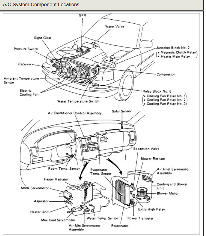

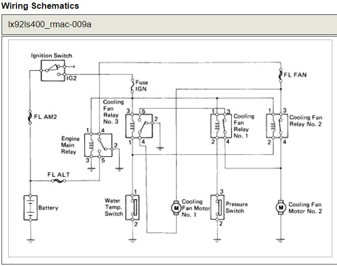

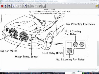

I have found the locations for you and a test guide so you can confirm the failure.
https://www.2carpros.com/articles/how-to-check-an-electrical-relay-and-wiring-control-circuit.
If the cooling fan is bad this guide will give you an idea of what you are in for when doing the job.
https://www.2carpros.com/articles/replace-electric-fan-motor
I have also found these diagrams to help you see what you will be fixing.
Cheers

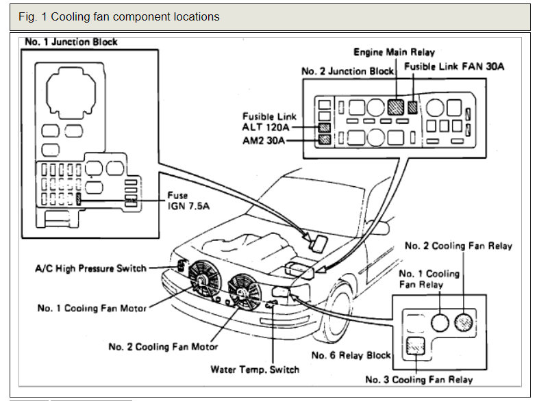

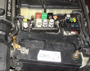

I uploaded a picture of the compartment I think you are referring to with the top diagram showing. Can you tell me which relay it is? No water in the cooling system? Is that the radiator overflow?
https://images.2carpros.com/forum/automotive_pictures/154609_lexus_engine_2.jpg
P.S. I wired the fans directly to the battery and they worked fine so the motors are good Thanks
Feb 7, 2008 at 5:16 PM
2CARPRO JACK
  • 11,533 POSTS

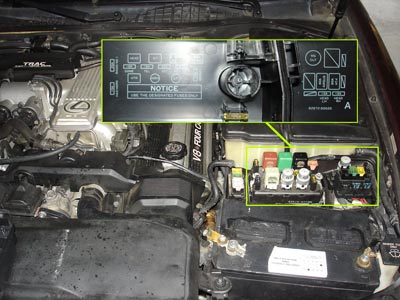

The legend on the post above shows which relays are which. Check it out :)
Feb 7, 2008 at 6:01 PM
KAPTIVATOR
  • 5 POSTS
Yes, I uploaded a new photo

Is that relay box behindthe drivers headlight. My software says the round relays and 1 square are for the fan, there are 3
Feb 8, 2008 at 7:37 AM
KAPTIVATOR
  • 5 POSTS
Well this power box sits behind the battery which is behind the drivers headlight.
https://images.2carpros.com/forum/automotive_pictures/154609_lexus_relays2_1.jpg

unbolt it and turn it over so you can find the wires with the same color as the ones that go to the fan
Feb 8, 2008 at 5:13 PM
KAPTIVATOR
  • 5 POSTS
I am sorry for the late update and feedback. I found the relays. The power box was actually located under the drivers headlight and casing. I had to remove all the drivers side lighting units and then the casing. Anyway I replaced all three relays and the fans are still not coming on, even when I turn on the air conditioning. The car is still running hot! Do you have any suggestions.

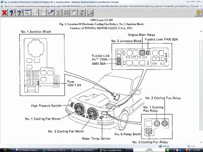

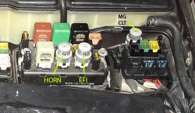

https://images.2carpros.com/forum/automotive_pictures/62217_Fans_1.jpg
Check the relays and the fuses, also the water temp switch in the side of the radiator, as for the head, you see any white smoke from the exhuast?

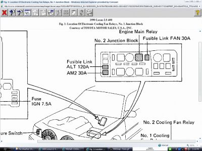

https://images.2carpros.com/forum/automotive_pictures/62217_Fansb_1.jpg
https://images.2carpros.com/forum/automotive_pictures/62217_Fansc_1.jpg

Check for power on the Yellow/Blue wire at the Water Temperature Switch (located on the left front of engine compartment - on the radiator).
Next make sure that the White/Black wire on the Water Temperature Switch makes a good ground. (Use an ohmmeter. With the Water temperature switch disconnected, connect one ohmmeter lead to the wht/blk wire on the Water Temperature Switch connector and the black ohmmeter lead to the negative battery terminal. The ohmmeter should read "0". If not. Clear the area where the Water temperature switch grounds on the right front fender.)

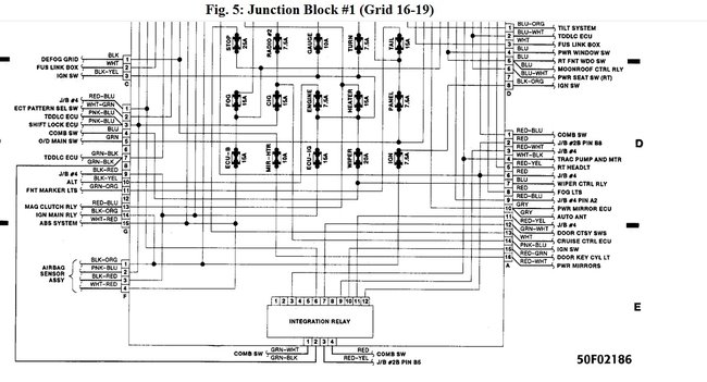

Check the IGN fuse (7.5A)

Since you have power with the Ignition ON, Ignore my request for you to check IGN fuse (7.5A).
Connect a voltmeter to the ground side of the temperature switch (the WHT/BLK wire) and let the engine run until it reaches the temperature where the fan would normally come on. If the voltmeter reads Battery voltage, then the temp switch is working properly. You'll have to check the cooling fan relays. Easiest way to do this is to switch them with an identical relay (the fuse box usually has more than one identical relay). After the switch, it the fans work, you know that the original relay was faulty.

Check COOLING FAN RELAY 2 to see if it has power on terminal #2 (remove the relay and check for power at relay socket #2) with the ignition key ON.
Also, with the IGN switch ON, check (for power) relay sockets #1 for COOLING FAN RELAY 1 and 2.
Next, with the IGN switch ON, check for power at relay sockets #3 & #4 of COOLING FAN RELAY 3.
If this doesn't turn up anything we'll check the ground and control sides of the relays.

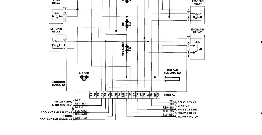

Check the 30 amp fusible link.
Also, check the 7.5 ignition fuse.
