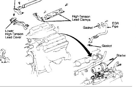

Where is the starter on 400 LS? Having a hard time locating it.
Dec 16, 2007 at 2:54 PM
SERVICE WRITER
  • 9,123 POSTS
HEH,HEH..... You have to remove the intake manifold, over 5 hours for a pro according to the labor guide.
https://images.2carpros.com/forum/automotive_pictures/30961_lex_1.jpg
Be sure to thank the engineers in your prayers.
