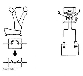

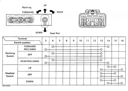

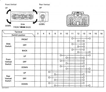

Hello - I will give you a couple of things to check. It could be the switch or the motor. Both checks below. POWER SEAT SWITCH Continuity Inspect the power seat switch continuity between terminals. See Fig. 30 and Fig. 31 . If continuity is not as specified, replace the switch.

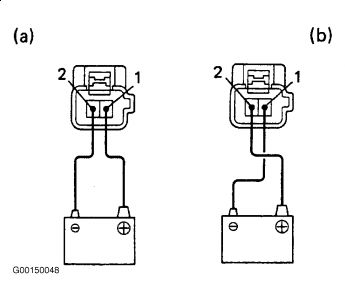

Operation (Passenger's Seat) 1. Connect the positive (+) lead from the battery to terminal 1 and the negative (-) lead to terminal 2. Check that the motor turns counterclockwise. See Fig. 34 . 2. Reverse the polarity, check that the motor turns clockwise. See Fig. 34 . 3. If operation is not as specified, replace the motor. See RECLINING MOTOR under REMOVAL & INSTALLATION.

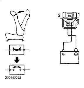

Circuit Breaker Operation (Passenger's Seat) 1. Connect the positive (+) lead from the battery to terminal 2 and the negative (-) lead to terminal 1 on the seat wire harness side connector, and put the "seat back" in the most forward position. See Fig. 38 . 2. Continue to apply voltage, check that there is a circuit breaker operation noise within 4 to 40 seconds. See Fig. 38 . 3. Reverse the polarity, check that the "seat back" starts to fall backwards within approximately 60 seconds. See Fig. 39 . 4. If operation is not as specified, replace the motor. See RECLINING MOTOR under REMOVAL & INSTALLATION.
