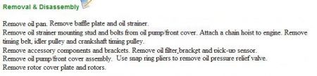

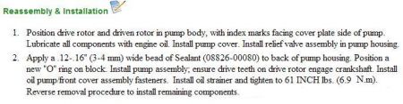

how do you replace oil pump? does engine have to be removed?

https://images.2carpros.com/forum/automotive_pictures/261618_Noname_737.jpg
https://images.2carpros.com/forum/automotive_pictures/261618_Noname2_192.jpg
