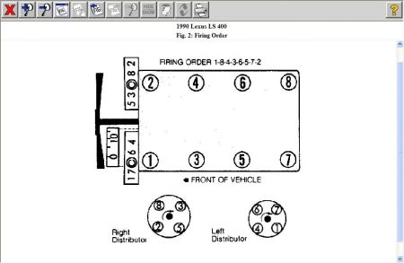

what is the firing order for this vehicle?
Jun 22, 2008 at 3:58 PM
  • 75,992 POSTS
There you go and have a nice day
