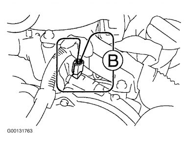

What is fault code 1656 OCV circuit malfunction and where I should look to replace component. Thanks.

Code for Oil Control Valve it adjusts oil pressure to chang intake cam position. Maybe open or short see diagram near oil filler
https://images.2carpros.com/forum/automotive_pictures/198357_Graphic_542.jpg
