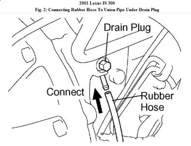

I WOULD LIKE TO KNOW WHERE THE COOLANT DRAIN PLUG ON THE ENGINE BLOCK IS LOCATED THANK YOU

Hi BRASI, Thank you for the donation. It is located on left side of engine block near the transmission.Attaching a rubber hose would allow you to collect the coolant and prevent spilling
