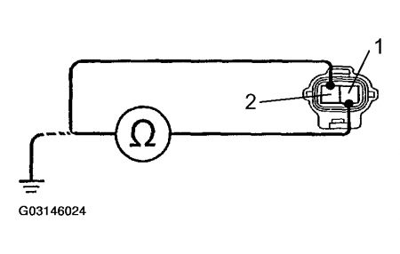

thanks for your time now i look back on my questions and they seem foolish i used a snap on scanner and some how pulled the codes,left front speed sensor throws a fault strain on the wireing may have cause it,anyway im ohming the sensors out tomrow got a spec?thanks for your help

.6 - 2.5 kohms is allowable
https://images.2carpros.com/forum/automotive_pictures/1639_lexus_1.jpg
