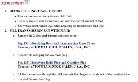

hi i just purchased a theft recovered is350 and realized that when the car is started and put into gear it will not accelerate and the rpm's will not move when the gas pesal is pressed. the check engine light and vsc light are also on. the car will also sometimes have a problem holding a steady rpm . it will go down to 700 and jump back up to 1000 rpm's. i have tried putting the car in gear and taking off the ebrake but it will move very slowly and will not respond to the accelerator. any suggestions would be great. thanks

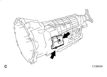

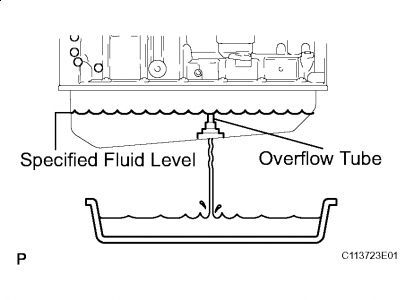

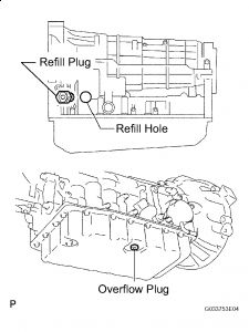

I have looked for the tranny dipstick but can't find it. Where is it located.
Dec 18, 2009 at 4:01 AM
MHPAUTOS
  • 31,937 POSTS
Hi there, there is no dip stick, the oil must be check on a hoist, theres a fill plug and a overflow plug that need to be removed, see pics. Mark.
