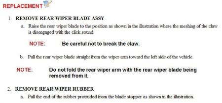

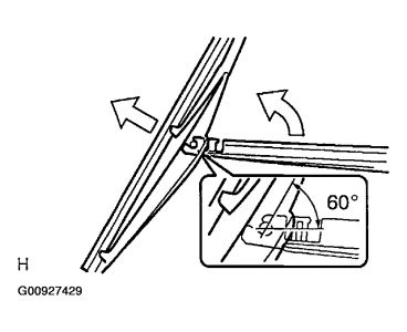

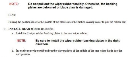

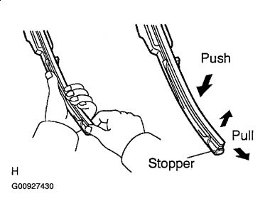

I cannot find a release button or tab for the rear wiper blade. I just bought this SUV and it feels like I might damage the wiper arm if I pry the blade off. Is there are release that I am not seeing?
