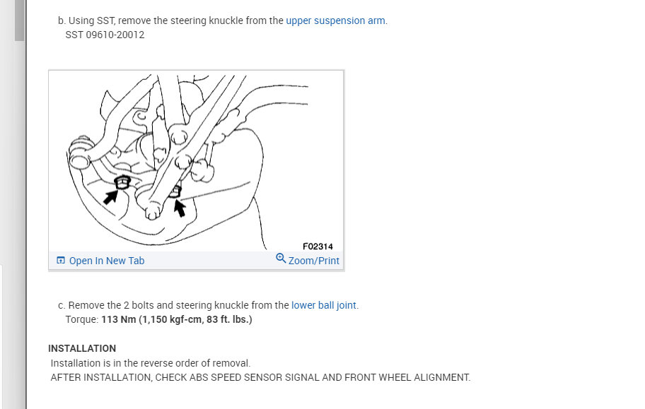

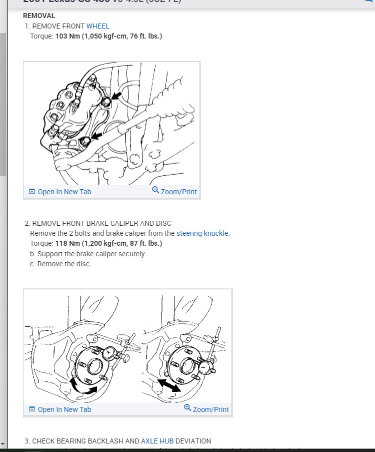

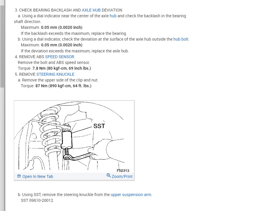

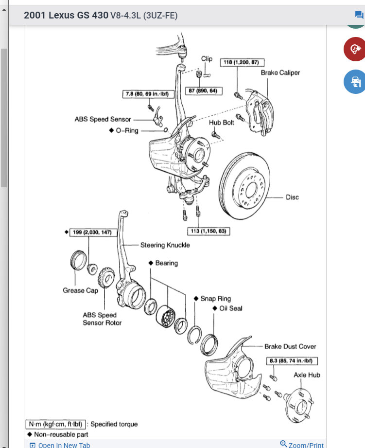

More than likely you have a high amount of run out on the hubs or even the wheels.
So, we need to start with checking the runout by using a dial indicator on the hubs and find out if this is the cause of the vibration.
Basically, this will cause the issue you are seeing so based on everything that has been done the runout would make the most sense.
I am attaching the complete process below on how to do this so let's run through this material and let me know what questions you have.
