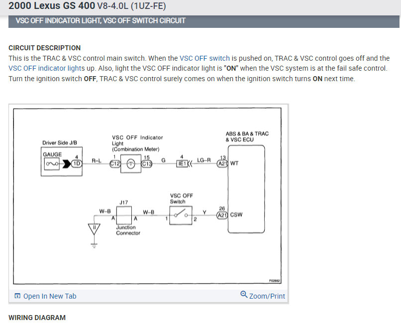

vsc light on?
2000 LEXUS GS 400
JASIM-
vsc light on and check engine 2 light on?
Sep 11, 2009 at 1:43 PM
SQM
  • 6,383 POSTS

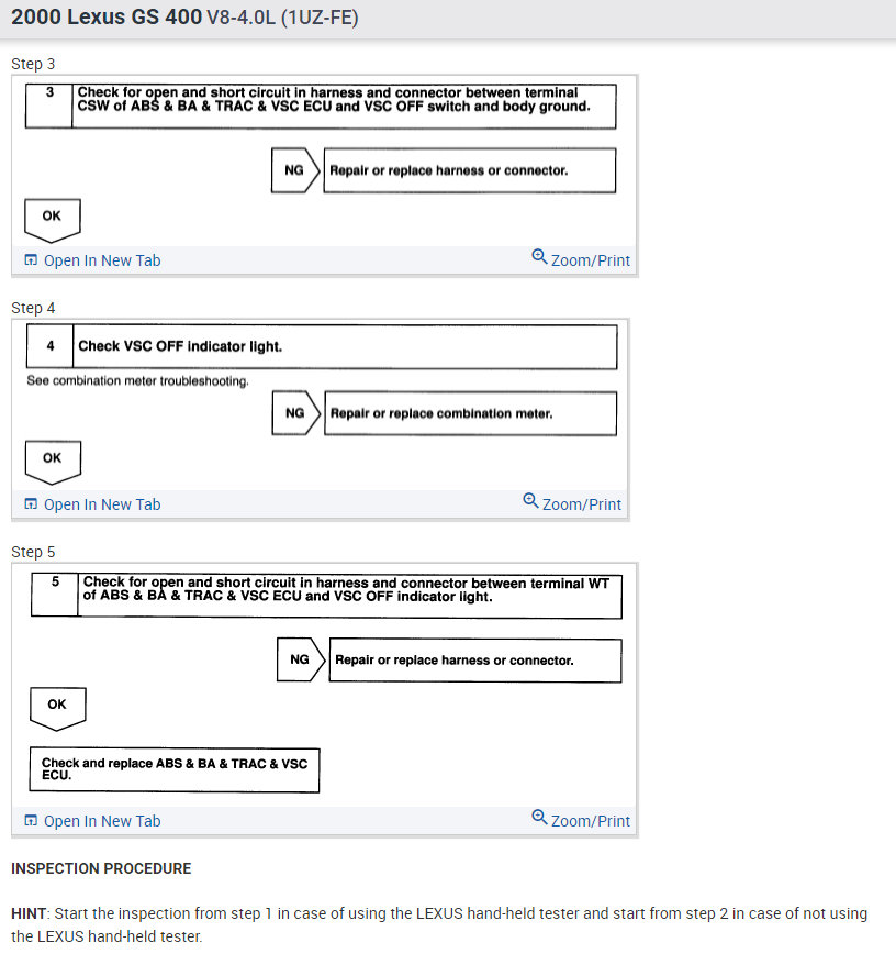

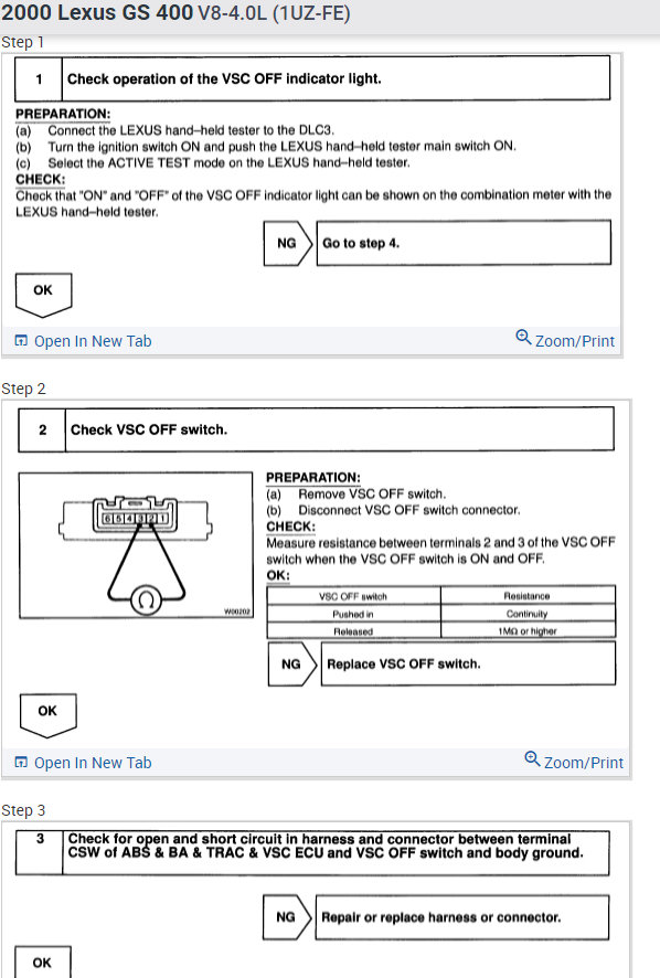

The VSC light will come on if there is an issue with the traction control system.
When the VSC off switch is pushed on, TRAC and VSC control goes off and the VSC off indicator lights up. Also, light the VSC off indicator light is "On" when the VSC system is at the fail safe control.
There are few components that can trigger that light. I have attached the diagnostics procedure for the VSC light.
For the check engine light. First step would be to get the vehicle scanned for codes. That was the diagnostics process can be narrowed down.
