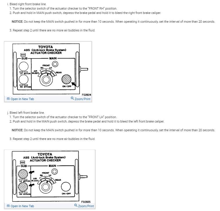

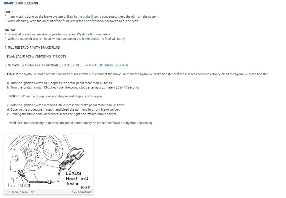

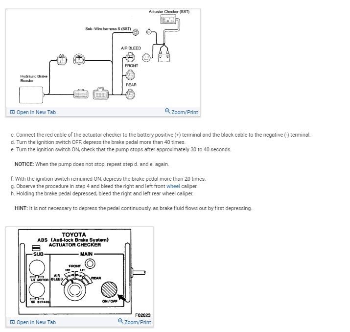

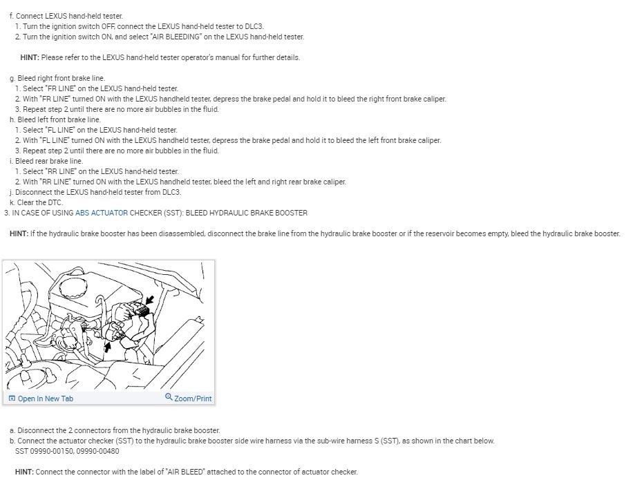

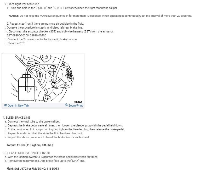

just changed master cylinder, need to know how to bleed brake system, this system has an electric accumulator motor. and abs,traction motor,
Mar 29, 2009 at 8:30 AM
EUGENE123
  • 273 POSTS
to bleed brakes Follow the procedure attached below
Read this guide first, not vehicle specific, but has some good points that apply to all vehicles
https://www.2carpros.com/articles/how-to-bleed-or-flush-a-car-brake-system
Vehicle specific instructions are attached below
