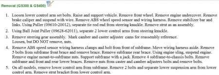

1998 Lexus GS 400 HOW DO YOU TAKE OFF FRONT LOWER BALL JOIN
1998 LEXUS GS 400
132,000 MILES • V8 • 4WD • AUTOMATIC
JADADIOR123
CAN SOMEONE HELP ME PLEASE
Aug 13, 2010 at 8:03 AM
BLUELIGHTNIN6
  • 16,542 POSTS
https://images.2carpros.com/forum/automotive_pictures/261618_Noname_2825.jpg
https://images.2carpros.com/forum/automotive_pictures/261618_Noname2_925.jpg
Oct 21, 2010 at 12:24 PM
