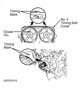

im replacing the water pump and the twin cam markings seems to have moved when i loosened the timing belt and was wondering how they should line up?

Hello I only show a GS 300 not a 350. For the GS 300 Timing marks on camshaft sprockets must align with timing marks on No. 4 timing belt cover. See Fig. 12 . If conditions are not as described, rotate crankshaft clockwise one complete revolution clockwise
https://images.2carpros.com/forum/automotive_pictures/248015_12_6.jpg
