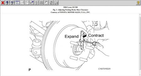

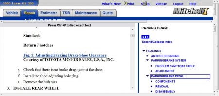

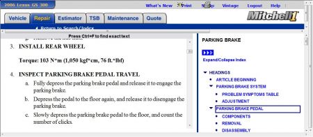

How do I adjust the parking brake shoe clearance? Does this normally have to be done when changing the rear disc rotor? Is there a specific orientation of the rear disc rotor needed when it is replaced on my vehicle?
Mar 17, 2009 at 12:47 PM
  • 75,988 POSTS
See below
