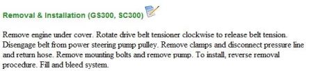

how do i remove a power steering pump from a 2000 lexus gs 300

May 14, 2010 at 2:34 PM
