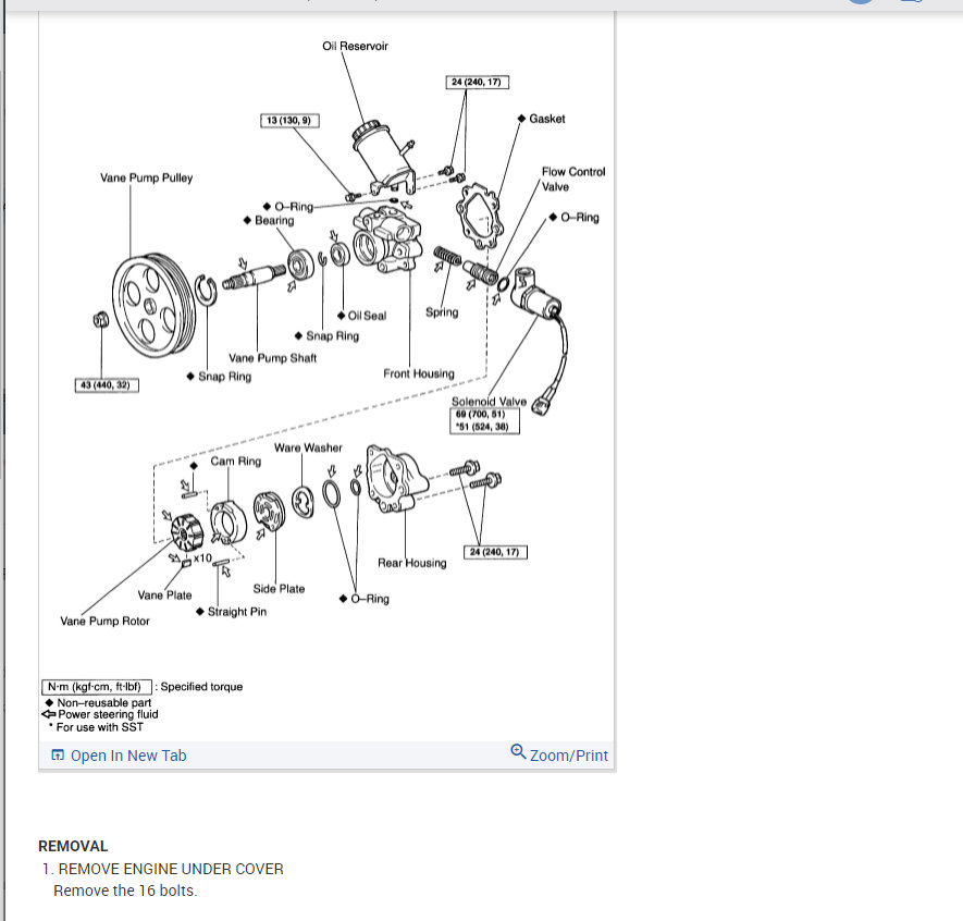

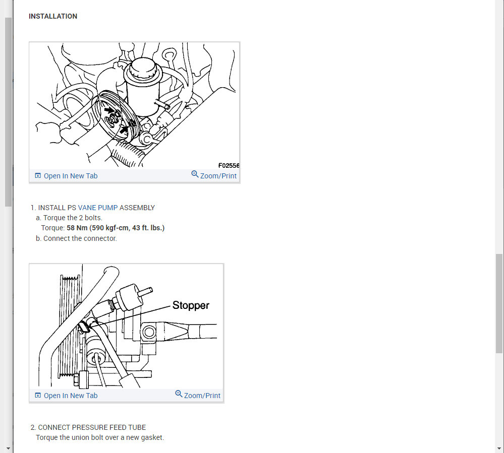

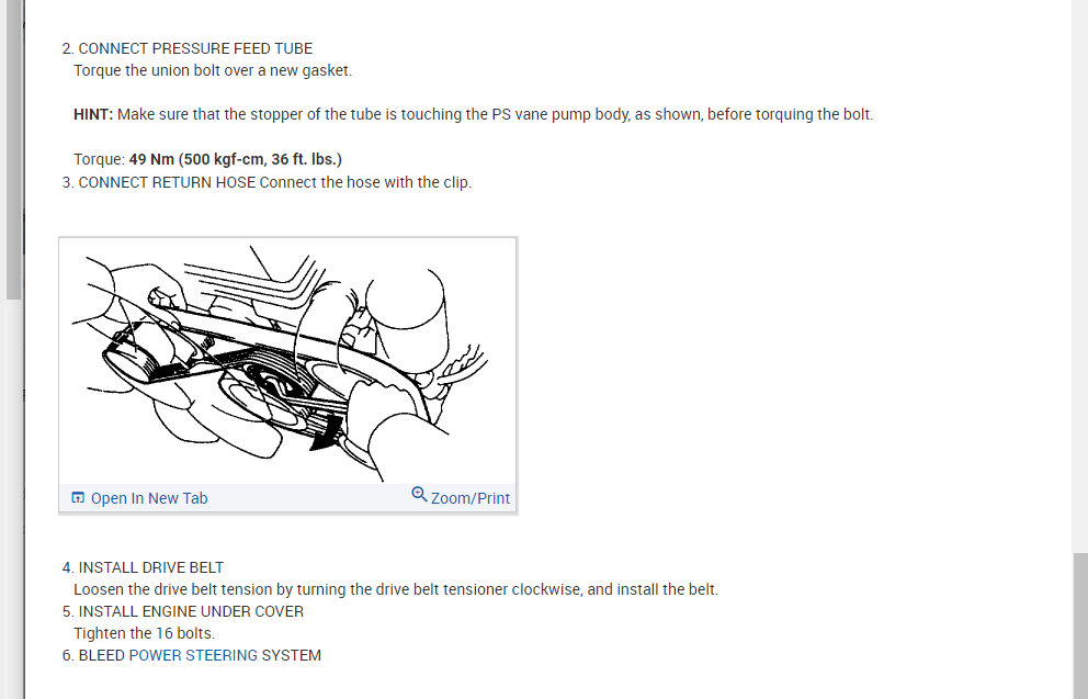

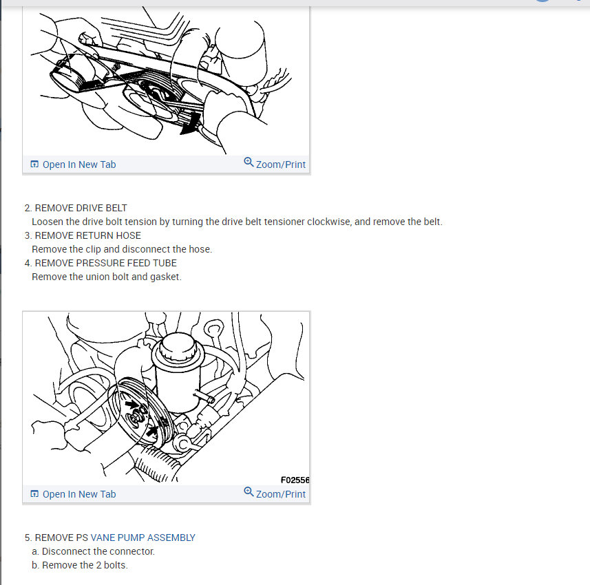

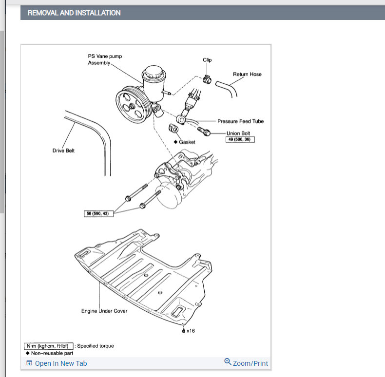

How do I replace or install power steering pump?
Saturday, April 24th, 2010 AT 6:36 PM
MECHANIC
18,907 POSTS
Here are some guides that will help with replacing this pump. Please take a look at these for more detail:
https://www.2carpros.com/articles/how-to-replace-a-power-steering-pump
https://youtu.be/C1h8Xl1E8hI
Below is the process from the manual that will help with the step by step process. Please let us know if you have other questions on this. Thanks
