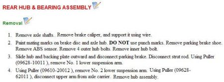

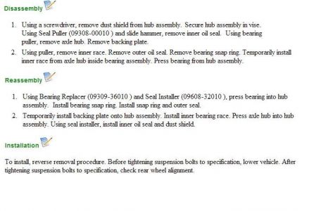

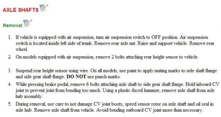

I need to change the left rear wheel bearing on my car. How much is involved in doing that, and are there any special tools required?
