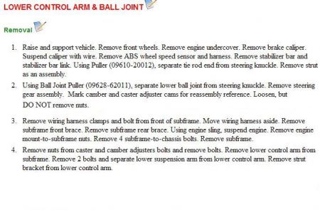

how do you change the lower control arm

https://images.2carpros.com/forum/automotive_pictures/261618_Noname_955.jpg
https://images.2carpros.com/forum/automotive_pictures/261618_Noname2_263.jpg

this is a complex job be very careful
