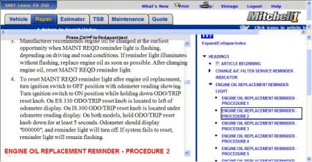

Oops, can't even push the correct keys on this keyboard. I own an ES, not a GS350. After changing the oil myself, how do I remove the warning "Oil Maint. Req'd"?
Can I change the mileage interval? TNX

how do I remove the warning "Oil Maint. Req'd"? Read no.4
https://images.2carpros.com/forum/automotive_pictures/12900_oil_7.jpg
