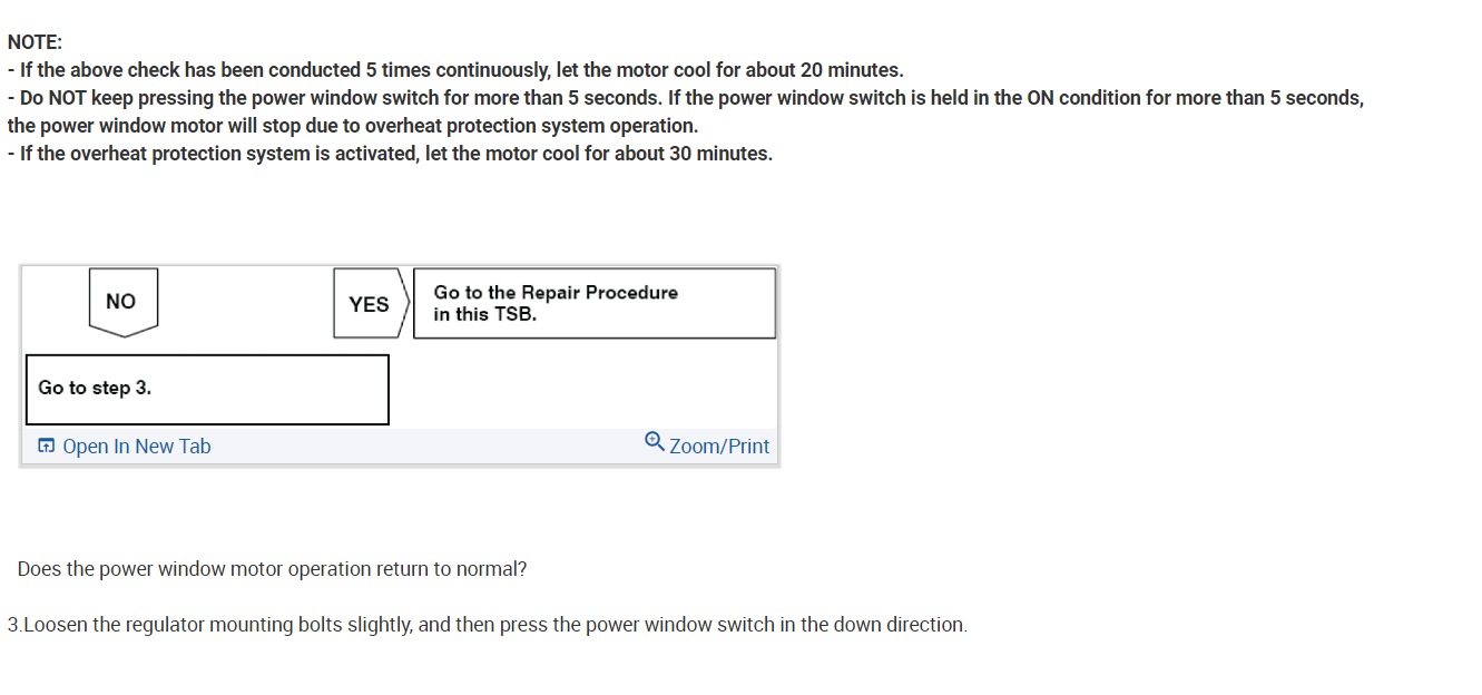

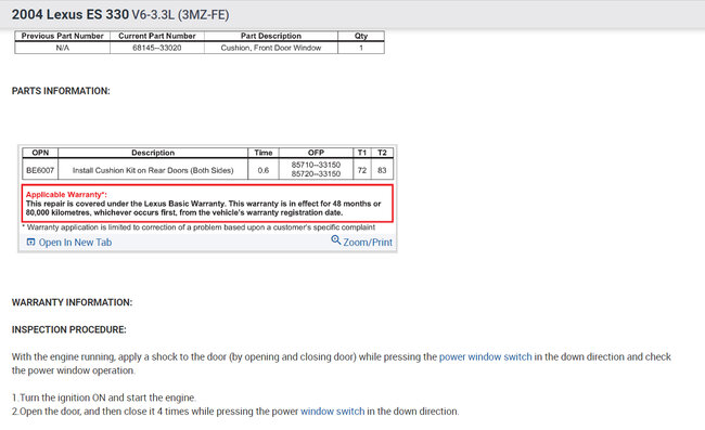

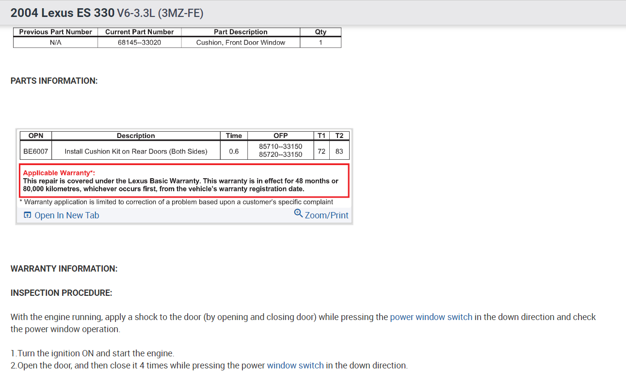

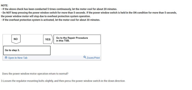

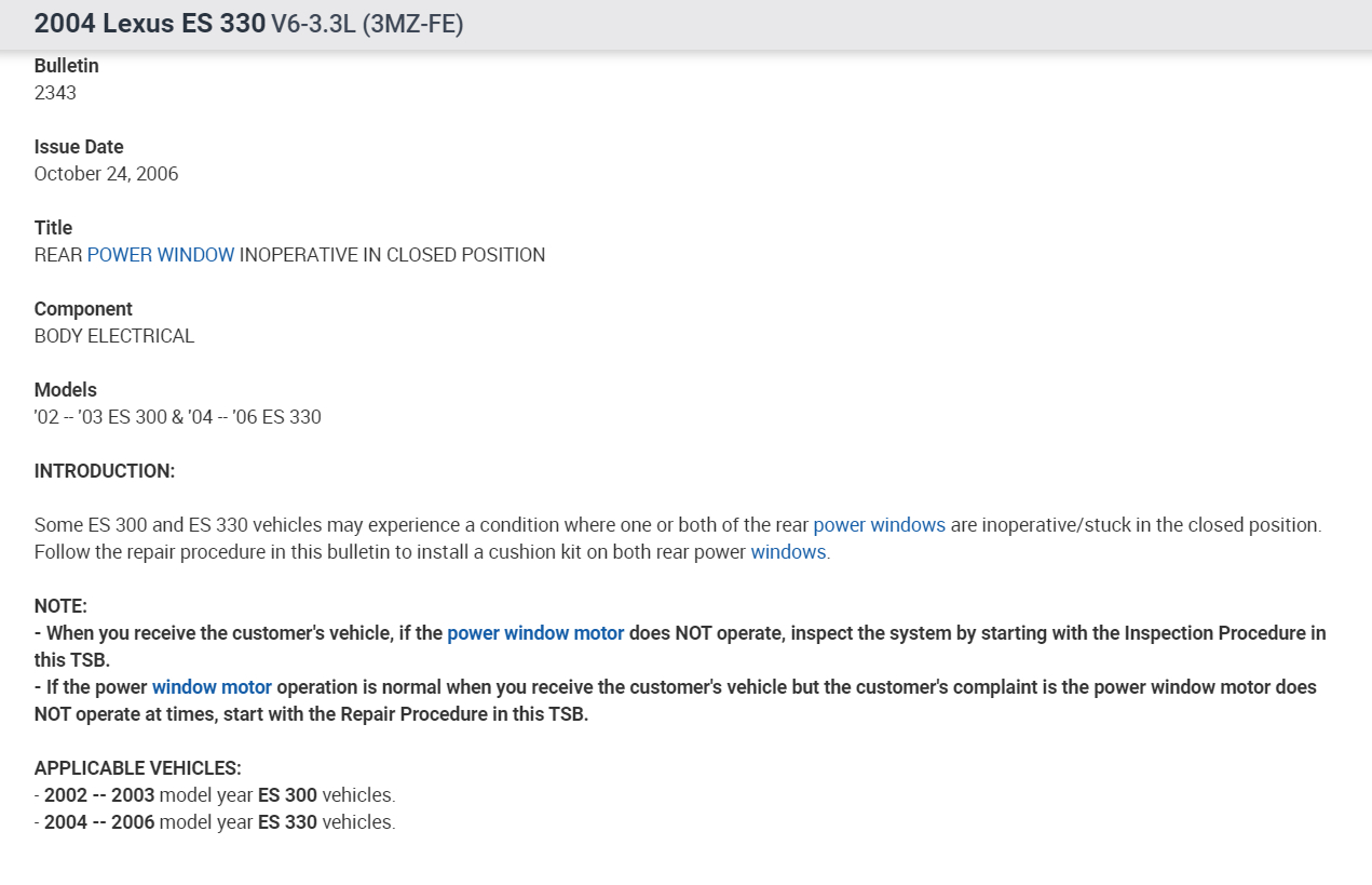

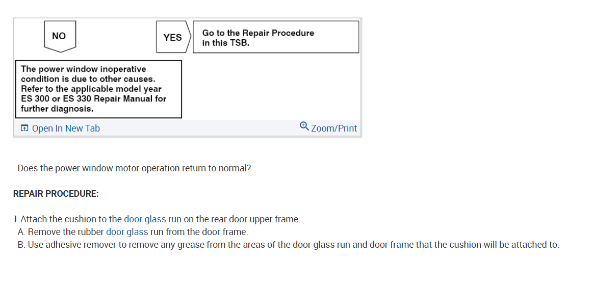

LEXUSHELPER

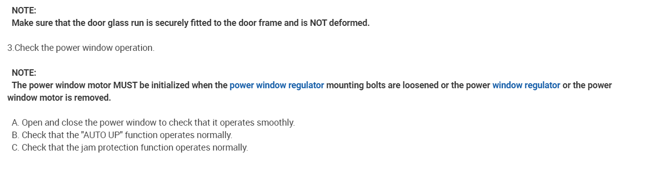

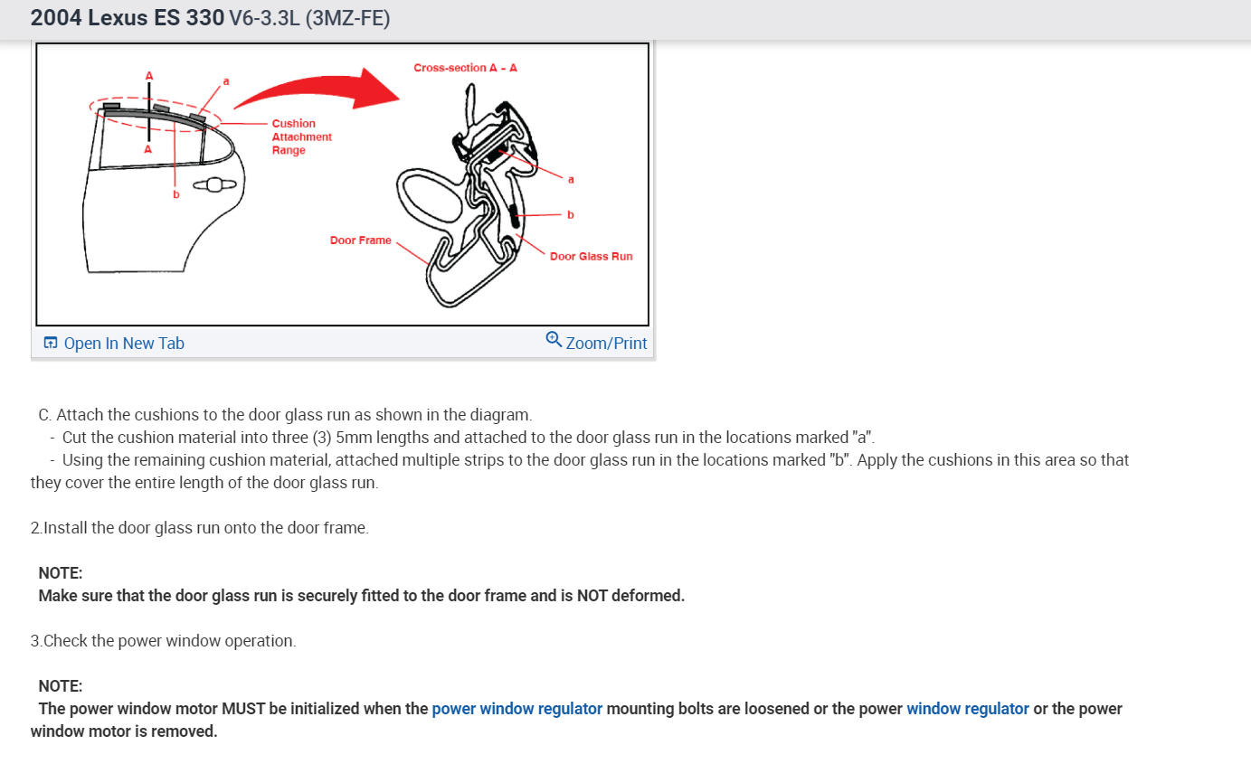

Press the window down switch on the Master Switch for the rear window and slamp the rear door hard or have someone tap on the window motor. This will cause the window motor to run again. Then you need to perform a updated TSB on the window run. Or else the window will get stuck again.
Feb 23, 2009 at 3:43 PM
  • 55,423 POSTS
Here is the bulletin (TSB). Check out the images (below). Please let us know what happens.
