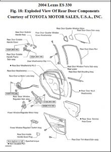

On one of the rear doors neither the window nor the door can be opened.The door can be opened only from outside,the window does not open neither from the rear control button nor from the driver button.The light in the window rear control button flashes twice at fixed intervals.I assume this is some error code but I can't seem to find an explanation about what it means anywhere.

It is the left side - behind the driver.It might be that the child safety switch in the door is deffective.It is in the off position but it does not make any difference if I move it to on.
If I move the other door's (the one that works fine) switch to 'on' I get the same result as the deffective side - the door opening handle behaves the same.
How difficult is it to open the door panel?do you have the instructions?

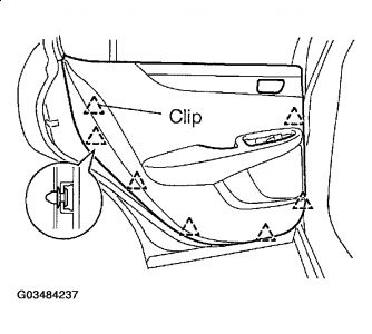

Hello - Thanks for the info.......... First please check PWR NO 4 fuse and make sure it is good If it is good here is the info on the door panel removal.........this is for an overhall so I only gave you up to the point of the door panel being removed. The first pic is an overall pic of the door
https://images.2carpros.com/forum/automotive_pictures/248015_f18_1.jpg

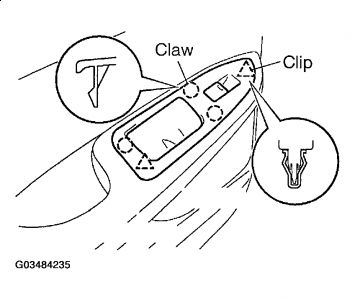

1. REMOVE POWER WINDOW REGULATOR SWITCH ASSY REAR a. Using a screwdriver, remove the power window regulator switch assy rear, then disconnect the connector. HINT: Tape up the screwdriver tip before use. Fig. 25: Removing Power Window Regulator Switch Assy Rear

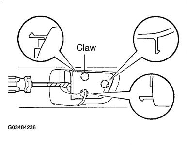

Courtesy of TOYOTA MOTOR SALES, U.S.A., INC. 2. REMOVE REAR DOOR INSIDE HANDLE BEZEL PLUG LH a. Using a screwdriver, remove the rear door inside handle bezel plug. HINT: Tape up the screwdriver tip before use. Fig. 26: Removing Rear Door Inside Handle Bezel Plug LH

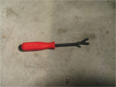

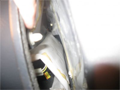

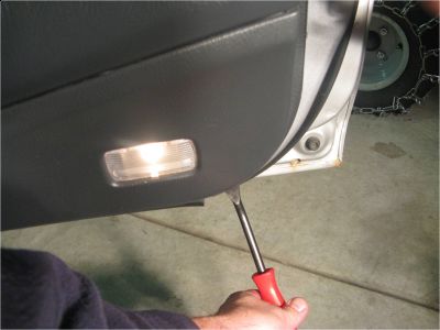

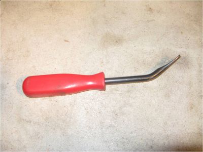

Courtesy of TOYOTA MOTOR SALES, U.S.A., INC. 4. REMOVE REAR DOOR SERVICE HOLE COVER LH a. Disconnect each connector and remove the rear door service hole cover. NOTE: Remove the remained tape on the body side. On step 3 where you are removing the door panel........the do make a tool for this also.....I have attached the pic
https://images.2carpros.com/forum/automotive_pictures/248015_1369_2.jpg
https://images.2carpros.com/forum/automotive_pictures/248015_1370_2.jpg
https://images.2carpros.com/forum/automotive_pictures/248015_1378_2.jpg
https://images.2carpros.com/forum/automotive_pictures/248015_1380_2.jpg
https://images.2carpros.com/forum/automotive_pictures/248015_1392_2.jpg

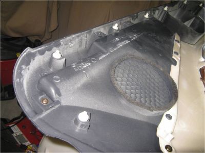

Also, I have attached a door panel showing the clips that you are pulling out.....for me, I purchase enough for the door panel first. They always break for me....maybe not all of them but for the cost it is better to have them on hand to put the panel back on when ready....you can always take them back. Just work slow if you have never done this before.......you might consider after you check it remove the other door (after calling the parts department to make sure both sides have the same part number) and put the right one on the left and see if that corrects the problem. If so, great. You will have to purchase extra clips though. Please let us know how it goes
