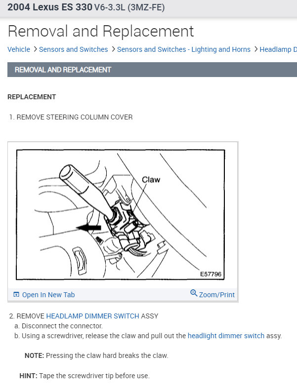

have low beams but when I attempt to turn on high beams, no change. High beam light comes on in dash.
fuses good, continunity on bulbs good.
Mar 1, 2009 at 7:35 AM
SQM
  • 6,383 POSTS

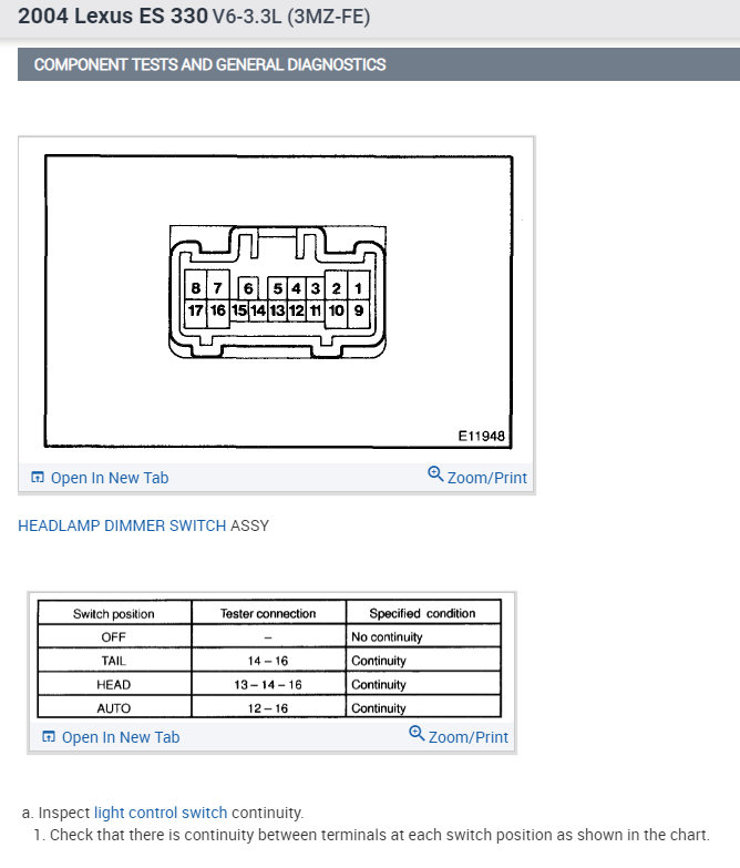

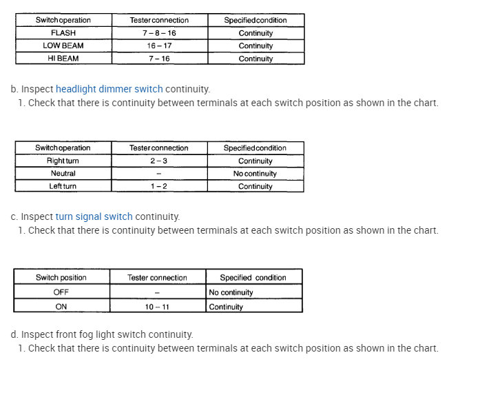

It sounds like you might have a faulty dimmer switch.
Since the bulbs are good and the wiring does not have any short the issue points to a bad switch.
https://www.2carpros.com/articles/turn-signal-switch-replacement
I have attached the replacement and testing procedure for the switch below.
