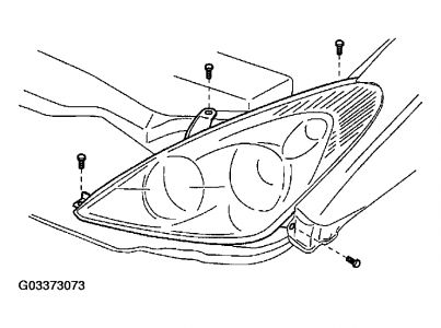

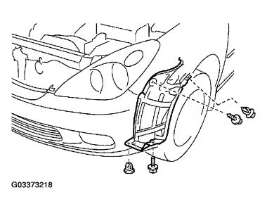

I am replacing both Headlight Assembly's The question is what is the best way to access the bolt that is down on the side of the fender? Would taking out the side marker lens allow easy access to that bolt or do I just have to struggle by using a open end wrench- I do have a set of ratchet box end wrench's but it is a tight fit

https://images.2carpros.com/forum/automotive_pictures/266999_lex_8.jpg
REMOVE FRONT FENDER LINER LH REMOVE FRONT FENDER LINER RH REMOVE FRONT BUMPER COVER HEAD LIGHT ASSY Remove the 4 screws. Disconnect the connectors. Fig. 2: Removing 4 Screws Of Head Light Assembly Courtesy of TOYOTA MOTOR SALES, U.S.A., INC.
https://images.2carpros.com/forum/automotive_pictures/266999_lex_9.jpg
Pull out the headlight unit forward. Remove the headlight assy.
