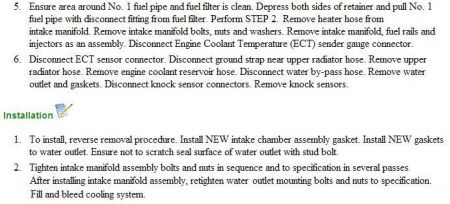

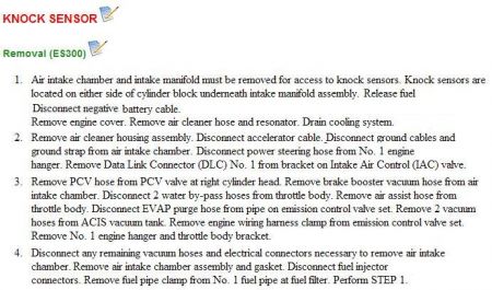

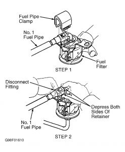

I need to know how to (R&R) the Knock Sencer.Could you tell and show me a step by step way to do it. Thank YOU, Allan Cory

https://images.2carpros.com/forum/automotive_pictures/261618_Noname_1681.jpg
https://images.2carpros.com/forum/automotive_pictures/261618_Noname2_527.jpg
https://images.2carpros.com/forum/automotive_pictures/261618_Graphic_336.jpg
Feb 16, 2010 at 8:59 AM
